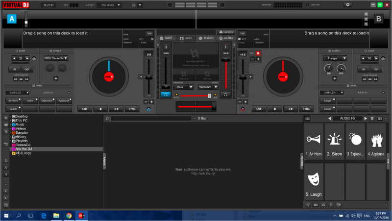

I have 8 pads on each side.
When the skin loads without the controller plugged in initially all pads popular correctly.
Once the controller is engaged deck two has pads 1 and 5 loaded with laughter only

So, which controller is the one that you plug ?
Can you post a screenshot of the Skin after you plug the controller, showing the Sampler on the Sideview and if possible the Sampler Pads pages on both decks ?

Image attached as per your request DJDad .....
Sorry forgot to mention it is for Stanton DJC-4 Controller
If the Mapping could be changed so that controller <shift> key and sampler key pushed together access PADS 5 - 8 I think That may solve the issue.
<Shift>+<Sampler_1> = SAMPLER_5 etc

SHIFT+SAMPLER is always mapped to stop the Sample in all default mappings and this is not going to be changed.
As for your request to access more samples from your controller, you can still map any keys you want to control any sample, however, you will not be getting the proper samples on the skin, as the unit has a pre-defined pads layout of 4x1 x 2(sides)
Try for example to map the STR_SAMPLER1 key you will find in the mapping as sampler_pad 5 (instead of sampler_stop 1 which is the default action) and see if that works for you.

Yes, i understood well.
SHIFT+SAMPLER buttons on the DJC4 should provide the STR_SAMPLER keys in Key Learn to map as sampler_pad 5 to sampler_pad 8
