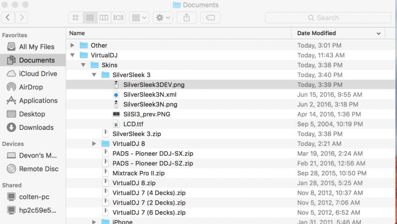

Tried to add a custom logo and rezip the file but It won't work.

So you've created a new file called SilverSleek3DEV.png?
That won't work, because the XML code references the original png file name. Adding a new one with a different name will not allow the XML file to see/use it.
You need to save your changed png with the same name as the original (overwrite it).

Thank you. So I can't send it to someone to edit and they send it back to me like I did. I have to do it on this same computer?

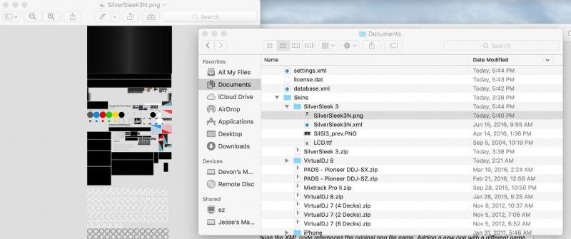

Wrote over the original file and now how do I get the software to recognize it?

You should recompress the SilverSleek3 folder to a zip file.
Right now on your skins folder you have a "SilverSleek3.zip" file which is the original skin and what VirtualDj sees, and a folder named SilverSleek3 with the new contents. That folder is not read by VirtualDj.
Rename "SilverSleek3.zip" file to "SilverSleek3_Original.zip" and then compress the contents of the "SilverSleek3" folder to a new zip file.
Don't compress the folder itself. Compress it's contents.
Then move the compressed file inside the skins folder and you should be able to select it from within VirtualDj

....or you could just take the newly modified PNG file and drop it onto the original ZIP - this should then replace the original PNG file with the new one.
At least that's how it works on Windows :-)

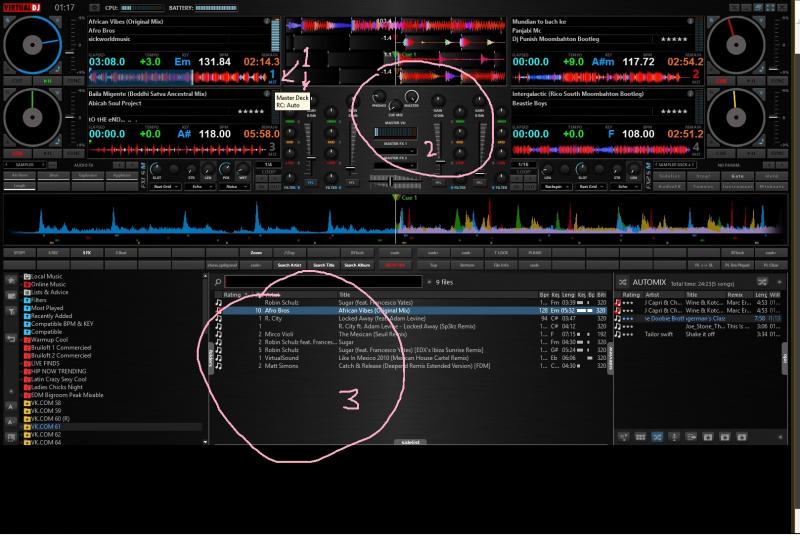

really good skin.. The best there is. However 3 isues:
1.) not clear when Master Tempo is on auto or not (Like in Fruit skin for example, it has a clear visual distinction) and even when mastertempo is NOT auto, right clicking master tempo shows RC: AUTO which is incorrect I think
2) no possibility to adjust sampler level. There could be room in this region. And vu meters would be nice on this view as well ;-)
3) Horizontal stripes would be really cool as an option.
This skin rocks though. Best I've come accross! Thanks for all your work
