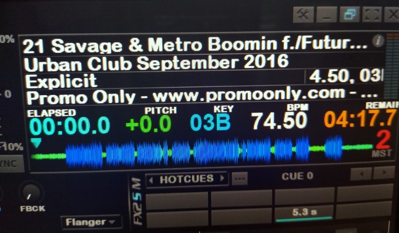

Phantom Deejay question ? i just started using your skin and did some editing to the XML file to change a few things to my liking. so i kinda know my way around your XML file pretty good Except for i can't figure out how to "Uncheck" some of the info that's listed in the "Field" as you see in my picture with all the Fields 1,2,3,4 etc,etc filled up it just looks messy to me with all them fields filled up with all that extra info. so i want to "Hide" & or "Uncheck" some of the info in those Fields 1,2,3 and so on. can you let me know what line # in the XML to change and or how to uncheck certain Field options thanks

You want to remove things from the skin menu, or from the deck screens ?
The skin menu starts at line #6948
The Deck info entries on the menu start at line #7020
There you can remove <submenu> entries.
However this will NOT change the info displayed on deck screens.
For this you must edit "everything" between lines #2694 and #2868
Posted Mon 13 Jul 20 @ 9:05 am
