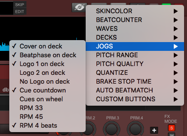

Just noticed the jogwheel can now be set to a new '4 beats' RPM mode. Great ! It looks very nice !
So I decided to add the setting in the RPM menu of my skin :
<submenu text="RPM" visibility="not skin_panel 'deck_type_video'">
<item text="1" action="setting 'RPM' 1" check="setting 'RPM' 1"/>
<item text="6" action="setting 'RPM' 6" check="setting 'RPM' 6"/>
<item text="33 *" action="setting 'RPM' 33" check="setting 'RPM' 33"/>
<item text="45" action="setting 'RPM' 45" check="setting 'RPM' 45"/>
<item text="4 beats" action="setting 'RPM' '4 beats'" check="setting 'RPM' '4 beats'"/>
</submenu>
It works fine and the correct mode is selected... BUT the check won't work... What should I write in order to get that item correctly checked ?

          Thanks, I know I could do this but again it's still a workaround...
BUT, you made my day. By reading your script I tried several new things and I found the good spelling !!
So thanks a lot :)
The correct check is :
<item text="Tooltips" action="setting 'tooltip'" check="setting 'tooltip'"/>
Works like a charm now ! :)
So thanks a lot :)

          For settings that are boolean (yes/no) you need to just call the setting
If you want to invert the check mark then you go like this:
check="setting 'tooltip' ? off : on"
For settings that are numerical values you query the value:
check="setting 'scratchZoom' 0.2"
Please notice that we didn't use single quote marks around 0.2 because it's a numerical value.
Single quotes are required ONLY when the setting accepts/returns text.
check="setting 'colorWaveforms' 'ultra-blue'"
So, your initial mistake was that you were using single quotes around 'yes' / 'no' converting it from a bool to a string :)

          BUT........
It seemed to work for a while... But now none of those checks are working anymore, thus the items are changing the option behavior correctly... Can't understand why...
<item text="4 beats" action="setting 'RPM' '4 beats'" check="setting 'RPM' 4.0"/>
</submenu>
If someone can explain me my mistake, thanks in advance...

          May I ask what RPM 1 and RPM 6 are supposed to be ?
RPM 1 means 1 round per minute, not 1 beat.
On the same principal RPM 6 means means 6 round per minute, not 6 beats.
Mind you that for most numbers you need to type them as floats. So,
<item text="1" action="setting 'RPM' 1" check="setting 'RPM' 1.0"/>
works fine here.
So does
<item text="33 *" action="setting 'RPM' 33" check="setting 'RPM' 33.0"/>
For RPM= 4 Beats, there's currently a bug preventing you to query the value properly but it should be:
works fine here.
So does

So what to do ?
<item text="RPM 4 beats" action="setting 'RPM' '4 beats'" check="setting 'RPM' '4 beats'"/>
action works fine, but no response in the menu...
If I update a skin, better this action (with no visual feedback for the user) or the other action/query (...check="setting 'RPM' 4.0)?!?
I'm confused, sorry.

          As I said, currently there's a bug there. Once it will be fixed by the team I will post again the proper way to query the value
    Posted Tue 22 Mar 16 @ 1:34 pm
          Check is still not working...
    Posted Sat 10 Dec 16 @ 4:43 pm
