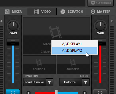

I use VDJ8 for music video projection whilst Dj-ing. Tonight for no apparent reason it wouldn't project to second screen, instead it made the video screen appear larger on my laptop. I have been using VDJ 7 for years without problems but since using VDJ 8 this has happened twice and I can't work out why. Any suggestions?

If your secondary screen (projector) is correctly set to "Extended mode" (and not clone), then you can select the Display that you want the Video to maximize, by right-clicking on the Master Output Preview window in the VIDEO panel (of the default skin)

Thanks Djdad, that's solved my problem.
