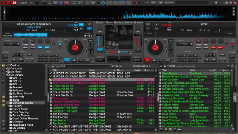

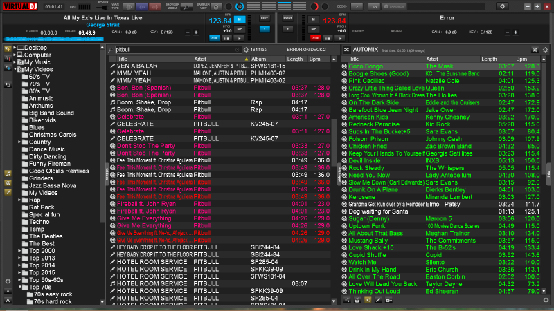

A new twist, when a title or artist is entered in the search bar, the browser is bringing up the songs, but also duplicating them. The duplicates do not work as VDJ has no path for the file. This only happens when a search is done, and seems it started a week or so ago. I am on build 2587.1086. .png)

          I'll be real interested to see what the answer is to this problem. I've had the same situation for months, but in my case every duplicate works. So it is mostly a distraction, but does not hamper my ability to pick one and continue to roll.

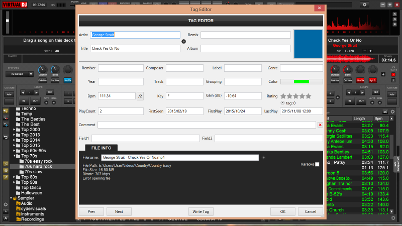

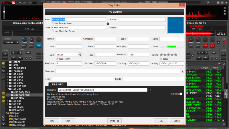

          Adion I did not run database clean up because all files are fine if I just go get them. This only happens when I search for a song. Here are 2 screen shots. One is the duplicate which will not work because of file path, the other is the one which will run. You can compare what the tag editor is seeing. Greets!! .png)

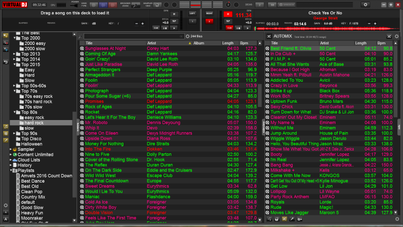

          Adion I am including one more shot here that may help clarify. This is what the database looks like if I just open a folder. You can see that there are no duplicates.:).png)

          The file path is different. One is C (your internal drive) and one is E, so at some point you've connected an external hard drive or USB flash drive etc. and allowed VDJ to scan/browse it.
You will have to clean the database if you want to get rid of the entry for the E drive, but if you connect that drive again and browse it, the files will be listed again (and duplicated, if they exist on C too).

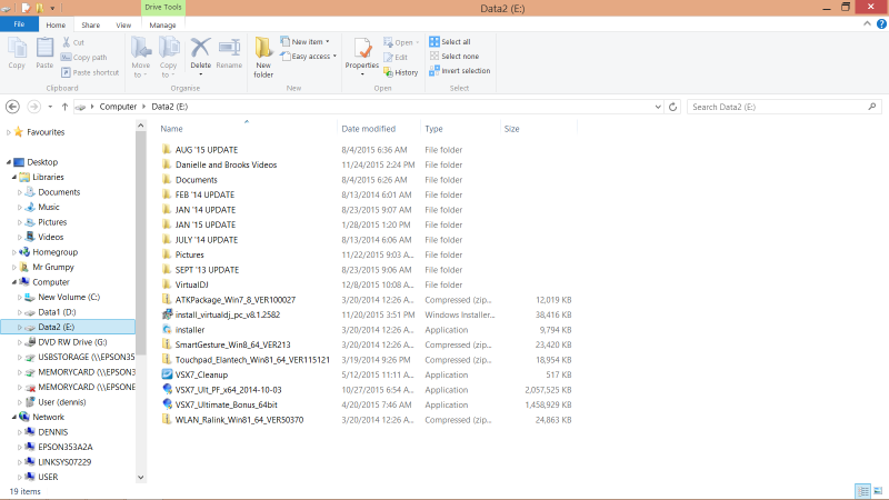

          Ok groov, the laptop has 2 hard drives, main is C:, D:, secondary is E:. I have never had MP3, or MP4 files on E: drive. So why is VDJ creating files from E: drive. I guess that's the question. As in this first screen shot, VDJ has pulled up a MP4 file from E: drive, that never has existed.?? And the second screen shot is everything that is on the E: hard drive..png)
.png) I have always had some karaoke files on E:, but VDJ has never duplicated them before now.
    .png)
       Posted Sun 13 Dec 15 @ 5:58 am
          Hey I just thought of something!! If you look at the E: drive pic, on 12/8/2015 I copied the entire Vitual DJ folder to E: drive as a backup. Seems this is about when duplications started. Could this be causing the problem? Maybe I need to keep that folder backup on an external.:)

          As a quick extra too, you can set certain drive letters to ignore in VDJ. I saw this same issue as well, because I use iTunes playlists everything looks right (1 copy of each song) when using that. But when you do a search VDJ finds all copies listed on all drives (and DBs). In my case because the DBs were exact copies of my laptop internal drive, there were multiple links to the same song on the laptop internal drive. But only when the USB drive was connected.
Also when I did a DB clean with my USB drive connected it would go really slow (compared to internal SSDs). If you set the USB drive letter to Ignore in VDJ you will eliminate both issues. Which reminds me, @Adion can we please have a simple drive letter setting instead of Hex value? I think people don't use that feature because it is intimidating. Even I was reluctant and I know Windows pretty well, but not like that. Besides, you don't even know the values to use unless you find the Wiki on the VDJ site.
