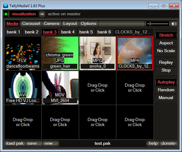

This image shows TM in normal non visualization mode:
This image shows TM in visualization mode and this was auto detected without restarting etc. In this case it did not miss a beat. The master that was up is now the visualization instance and will be tracked. The deck 1 instance has been has been unloaded. When in visualization mode, any interaction with decks is prevented for TM but it does it in a way that makes the most sense that is possible. If the visualization is actually on a deck, then all behavior is normal except activation which is prevented at all times in the TM user interface and VDJ handles that in it's own way. Would be nice though if you would stop calling OnStop and OnStart when user clicks to deactivate the vis.
It is kind of cool watching this change state and track and acts like it knows what it is doing and it does :) Unfortunately tied to the current implementation of visualizations in VDJ but I am prepared to change as necessary so if you could give me heads up that would be good.
