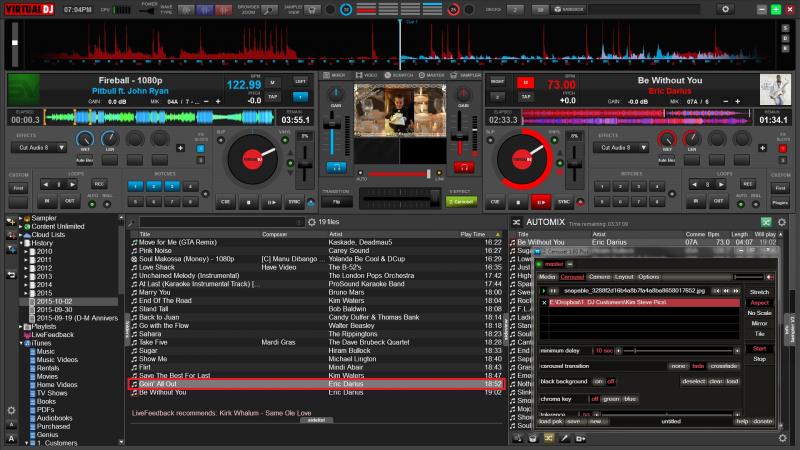

Hate to be a pest, but any idea how I can help get more information to track this issue down?
Posted Tue 22 Sep 15 @ 12:00 am

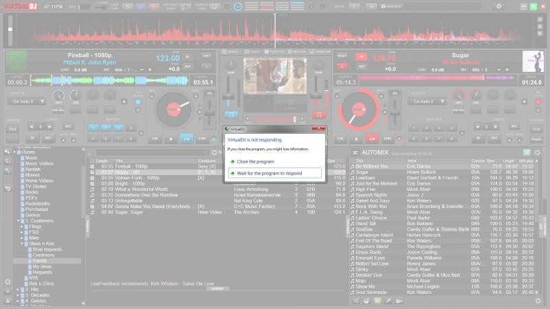

So I rolled back to Public build 2441 last night for the wedding and crashed twice. It seems as though this crash is when using Automix. It eventually just stops loading the next song and that is when the hang starts. Windows does not report VDJ as hung until you try to do something else to correct it. You can see in the second screen shot that deck 2 is in Automix and no second song loaded.
The Dinner music during this time is nothing new, stuff I commonly have played for years. The first hang was 7:01pm before this and I had been using Automix for about 1 hour. All of a sudden the music stopped but I had plenty in the list. When I checked out why VDJ was not playing, it was just hung but Windows did not bring up the error like you see in the 2nd screen shot below. I did not take a screen shot of the first one but Deck 2 was just like shown in the second screen shot. It had played out the top song and did not load a next song. That is when I tried to load deck 1 to get something playing, then the crash. Here was my history and I highlighted the song that VDJ crashed on the first time
This next one was during the second crash, just 7 min after the above screen shot was taken.
My party (that started this thread) was not a Video event and no plugins were running, but this time I was using Telly Media. I did not use Automix for the rest of the night and had no issues.
Posted Sat 03 Oct 15 @ 12:20 pm

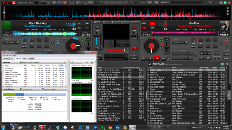

I am getting fairly frustrated that no mods or devs have resoponded with help. I just crashed VDJ 8 build 2441 again tonight while testing. I was connected to the internet too. I also took video of the crash, please respond with who I can give the videos to.
So far now 4 crashes in Automix only Dan offered to help off someone else's VDJ 8 crash thread on Facebook.
Here is my screen shot once VDJ stopped playing music, but Windows has not reported it as hung yet. Not the "Remain time" on the left deck is -25 seconds. It got up to about -2 min before I tried to close VDJ. The deck would not stop and my video shows that. The Record for deck 2 on screen even kept spinning.
Posted Wed 07 Oct 15 @ 9:54 pm

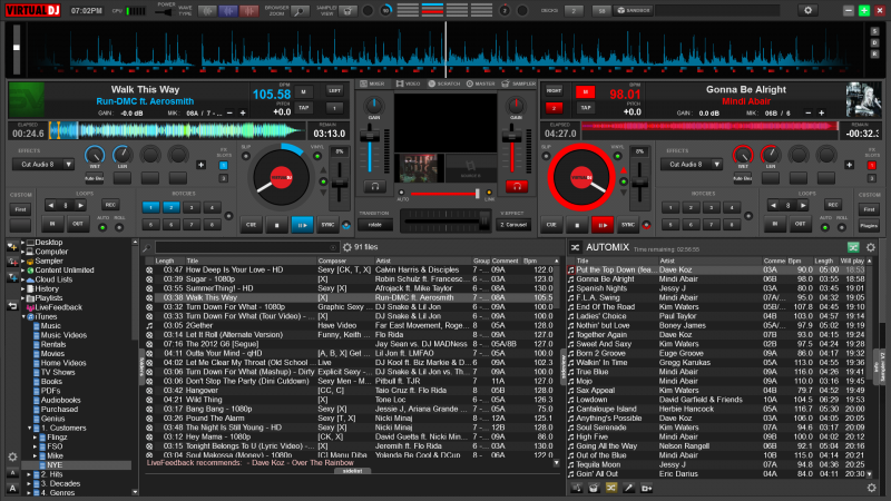

So just got a a fifth crash. Here is how I seem to be able to do it (same sequence as wedding)
Load my dinner playlist in Automix
Hit shuffle once
Load deck 2 with Automix list song, press Play and then press Automix to add the next song - walk away and always, seems fine - This was cocktail hr
Come back later
Play something else on deck 1 (does not have to be full song). Stop deck 2 and turn off Automix - Leave Automix populated - This was wedding party intro step
Load another song in deck 2, play and fade in (does not have to be full song) - This was Bride and Groom intro step
Load another song in deck 1, play and fade in (does not have to be full song) - This was First dance step
Delete partial played song at top of Automix list - From cocktail her
Load next song from the Automix list to deck 2, Play, fade in and turn Automix back on - Back to dinner jazz step
Walk away and wait for eventual silence
Crashed twice that way today and twice during the wedding with Build 2441, about 10 min + after last step.
I just updated to new public Build 2465 to see if it is fixed. Testing now. Screen shot from 5th crash:
Hit shuffle once
Come back later
Posted Wed 07 Oct 15 @ 10:23 pm

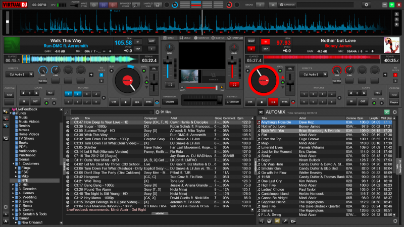

Both times you can see that I took screen shots before Windows reported it as hung and forced me to close it. Crash #4 was especially weird as that was the first time I saw the Remain time go into negative numbers.
Both times I was connected to the internet, just like 10/2/15 crashes. Not sure if I have any reports... That is everything I know at the moment. I can send the videos and crash logs if someone can offer to help me here.
Posted Wed 07 Oct 15 @ 10:51 pm
Hey just crashed a 6th time this same way, only now with VDJ 8 Build 2465. it was just like the #4 crash where it kept counting into the negative. So now what? Uninstall and go farther back? Thing I will try swapping out the exe for build 2438 next.
Posted Wed 07 Oct 15 @ 11:04 pm

Well, I will can try the beta but first let me say I ran VDJ all night. This time with Telly Media set as the Audio Only Visualisation. Build 2438 ran the full set, 3+ hrs (played very quietly). I woke up in the middle of the night to check. No crash
I then updated to the latest 2465, again with Telly Media set as he Audio Only Visualisation. Stable so far. Almost done with a 3 hr set. No crash.
But you are correct, every time it froze, the play list was not at the end. Automix just stopped loading the next song. I will send you a link to the video by email. That last lock was crazy and the first time I really played with the controls during lock to see what happens. I did that all on a short video.
I did shorten my testing last night to just loading a music video to get the video window active, then flip to the other deck and start playing Audio only. Wondering at this point if it is a stability issue with Spout Receiver and Automix (or possibly the amount of audio songs played). Or is it because Spout Receiver was not receiving anything, because Resolume was not running and screen was black. I did see at one point deck 2 video screen unloaded, but deck 1 and main showed active. You can see that in my 6 th screen shot. Not sure how that can happen, but that would hint to a Spout crash.

Yes, I still crashed it with Beta 2483 and Spout set as Audio Only. --As a guess-- It seems to only be a problem where Automix makes multiple calls to Spout to start because of back to back Audio only songs on the same deck. I seem to remember similar instability problems at one point with Telly Media running as Audio Only Vis. I just feel like I remember Don warning us about this same Audio Only Vis issue for TM too where it was making multiple calls to the plugin to start, or not reporting correctly, or not stopping "cleanly". It really should be looked at from the VDJ side to see how that can be handled more "gracefully". In all my crash screen shots (during the crash) the Video deck 2 is empty. It should at least be black with Spout not being fed anything and video still active on deck 1 and main.
