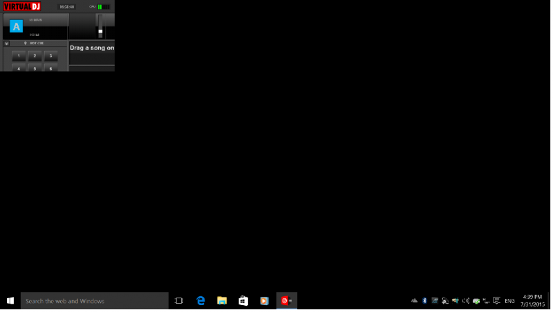

any ideas?
W10
asus gtx 560
17 2600 cpu @3.40
4gig ram
64 bit os
this is what it only shows
W10
asus gtx 560
17 2600 cpu @3.40
4gig ram
64 bit os
Posted Fri 31 Jul 15 @ 2:16 am
Check the Video driver - looks like you are using a MS generic one instead of the manufacturer one.
Posted Fri 31 Jul 15 @ 2:20 am

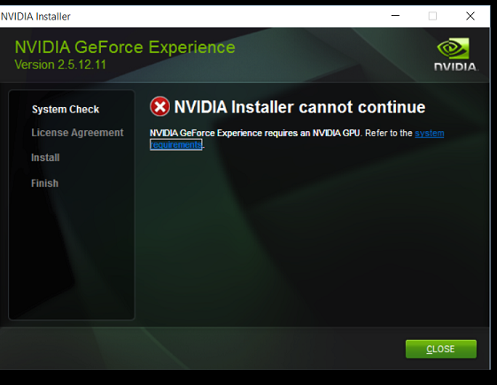

iv tried to update my drivers from GeForce.com and I keep getting this

i know the problem now with my Video Card... it needs TWO 6 pin power plugs and my power supply has ONE 6 pin plug... damn video card with two 6 pins
Posted Fri 31 Jul 15 @ 10:25 am
What the...?
How is it even possible to run without the second connector?
Anyway, I don't think that this causes the problem that only a part of VDJ is displayed.
Posted Fri 31 Jul 15 @ 10:43 am
iv disconected the gtx 560 now and i have full view of VDJ8
i did a you tube search on my vid card and it mentioned i need two 6 pin connectors
Posted Fri 31 Jul 15 @ 10:51 am

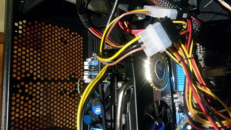

all i did was restart my computer then the full screen reset
Posted Sat 08 Aug 15 @ 12:30 pm
Found these two connection on the bottom of all cables and connected my 2nd power cable to my vid card.
after an update driver for vid card, my card is working fine.
I have a full vission of V8.
Posted Thu 13 Aug 15 @ 10:22 am
And yes, its a two 6 point power system card
