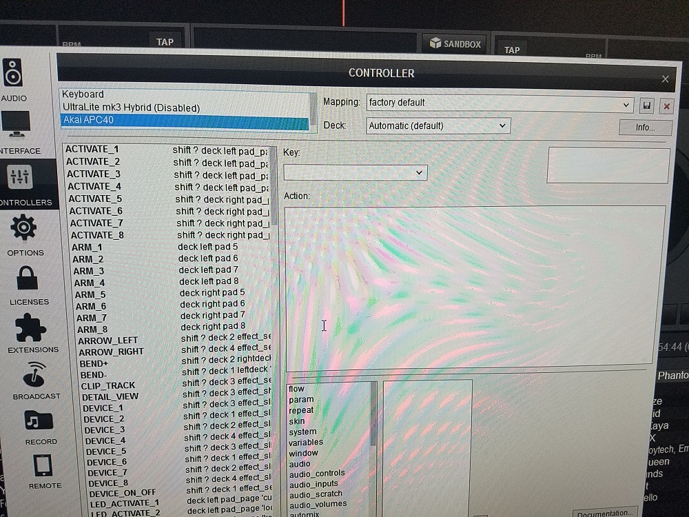

Same situation here. I just decided to give it a shot and try VDJ 2018 with APC40 according to http://virtualdj.com/manuals/hardware/akai/apc40/controls.html.
Hmm, "something" is working but it's way too far from what I expected.
Still, after making the connection the APC40 is detected correctly but not the mapping. Any solutions?
Don't you get the factory default mapping in VDJ Settings->Controllers tab and the functionality described in the manual ? Or are you trying to use custom mapping ?
Posted Sat 20 Oct 18 @ 1:59 pm
Yes, with the factory default mapping, Deck: Automatic (default)

Ok, so it doesnt work as described in the manual ? If not, then please be more specific.
If you want different functionality, you could create a custom mapping and of course we could help with any scripts you may need.
Posted Sat 20 Oct 18 @ 10:53 pm
Sure, to be more specific: none of the buttons, knobs and faders that are shown in the manual for APC40 on VDJ website are working. Not even the crossfader.

There is a chance your APC40 is "mapped" with some custom pattern, and its elements (button/faders/knobs etc) sent different data than the "default" ones. Please do this test..
- Run this tool (Miditrace)... http://www.virtualdj.com/download/miditrace.exe
- Select the APC40 from both top-right and bottom-right lists
- Try to move a few faders/knobs and notice the data registered in the large left-side window.
E.g. for Crossfader, you should get data in form of B0 07 xx , for MASTER VOL data in form B0 0E xx, for TRACK 1 data in form of B0 30 xx.
Let me know of your results.
Posted Sun 21 Oct 18 @ 10:24 am
B0 0F 7F 00 fader
B0 0E 7F 00 master volume
80 5B 7F 00 play
80 5C 7F 00 stop
80 5D 7F 00 rec
80 50 7F 00 stop all clips
80 62 7F 00 shift
Posted Sun 21 Oct 18 @ 5:45 pm

After reading the entire topic, and checked the mapping files, i realized that there are a couple of missing actions in the mapping, but i can't accept that nothing is working
Anyways, since we dont have this unit - mapping was made with the help of a user , so we were relying on his feedback - you will have to help us on this...
1. Crossfader. Indeed its missing from the mapping. Will be added to the default/factory mapping.
In the meantime, just to make sure it is properly defined , try to map it as .. (obviously) crossfader and see if its working.
2. PLAY, STOP and REC buttons (above crossfader) indeed missing from mapping file. Will be added. You can try to map those (just to be sure they work), as play_button, stop_button and record respectively.
3. Do Pads 1 to 40, trigger Samples ? If not, can you see what do you get with Miditrace when those are pressed ? BTW, please write here what you get (e.g. for Pad) when pad is down (probably 90 35 7F) and the data that sends when released (something like 80 35 00 or 90 35 00)
4. As you said, the Master Vol seems to be sending B0 0E 7F 00, so i assume you get values B0 0F 00 (minimum) to B0 0F 7F. Is that is so, then knob should work fine. If for example you trigger a Sample (from GUI), doesnt this knob adjust its volume ? Actually it should alter the volume of all samples, since it is assigned as the Master Volume of Sampler.
5. Apart from the ring-type LEDs of some dials that may not work properly, what about the FX section (Nr.14,15,16,17 in manual). None of them handles the Effects on Decks 1 to 4 ?? If not, please let me know the data you receive in Miditrace for any of those that doesnt.
6. NAV UP/DOWN/LEFT/RIGHT (buttons Nr.7 in the manual) .. dont they select previous/next Sampler Bank ? If not, please report here what data you get form them in Miditrace ?
We apologize for the trouble and inconvenience. As said above, the mapping was verified by a user before we added as native, but if anything is missing or not working properly, i am pretty sure we can correct it , with your help.
Posted Sun 21 Oct 18 @ 11:34 pm
Hi DJDAD.
MY BAD! I APOLOGIZE!
Pads [11,12] are working fine :-)
Pads for trigger samples 1 to 40 are fine too :-)
I guess if fader, play and stop weren't working I assumed that nothing was actually working :-)
I thought that Master volume fader was supposed to control VDJ's master volume (not the sampler's master volume)
I get this now. This map for APC40 is created mainly for use with sampler and A/B deck effects
Thanks for your help!
