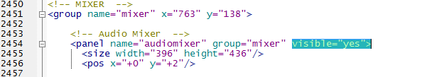

Center (mixer) panels dont appear when u load the skin. I get an empty area (actually just the Crossfader and the XFader Assign buttons are visible). Can you check the visible="" of your panels and make sure one of them is set as visible ?

Not sure what you mean.. It all works fine for me..?
If you load up the standard skin, and then make sure that you are on the audio mixer being visible and then load my skin does it work? I thought that which mixer you saw was down to a section of your settings file not down to the skin...??

Do you mean like this? I haven't changed this at all..
Posted Wed 08 Apr 15 @ 8:19 am
Are all the mixer controls in that same "audiomixer" panel and "mixer" group?
Posted Wed 08 Apr 15 @ 11:40 am
yep
Posted Wed 08 Apr 15 @ 11:56 am
Sorry, your skin cannot pass unless you find the bug with the center panels.
