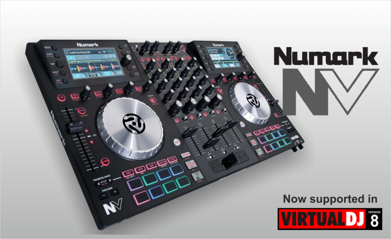

As of builds 2174.951 (or higher) the Numark NV is officially supported in VirtualDJ 8.
Operation Guide : http://www.virtualdj.com/documents/Numark%20NV%20-%20VirtualDJ%208%20Operation%20Guide.pdf
Numark's product page : http://www.numark.com/product/nv

          Cool!
Those look like exactly the same screen images as the NV displays for Serato - so is that part of the NV firmware?
I was wondering if the screen data was embedded in the VDJ executable, or how the screens would be displayed when using different skins.

          the screens cannot be customized (they re embedded in firmware). Data sent via large sysex which update the status of the screens. So, yes the screens will look exactly like they do in Serato.
