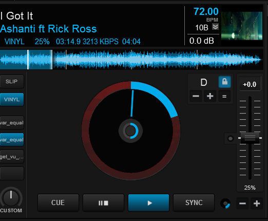

Unfortunately I still encounter the bug on deck 2... Even with 2174... At home with a mobility radeon hd 3650, and also at work with a Intel(R) 4 Series Internal Chipset.
I'm ok that I must review the code according to the new cover mask... My concern is, if you ever opened the xml file of my skin you may have noticed that there's only ONE jogwheel... No mask problem on deck1, but mask problem on deck2, with the exact same procedure called twice... How may you explain that phenomenon ?
Posted Thu 12 Mar 15 @ 6:53 am

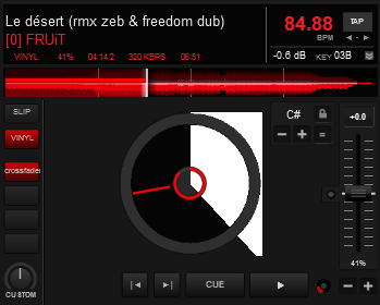

I was disapointed because the bug did not happen every time...
I just understoud how to make the bug still happen :
If VDJ is (re)started while the menu deck / wheel / art option is enabled, it will show the bug.
If VDJ is (re)started with the option unchecked, no bug.
@Dan : I talk about this :
Posted Thu 12 Mar 15 @ 7:16 am
The mask on the right is a red ring with transparent background, the mask on the left is a blue ring with transparent background so they're not the same.
The clipmask expects a black/white graphic though.
Posted Thu 12 Mar 15 @ 7:20 am
But the procedure that calls those two graphics is one and only...
So blue is good and red is dead ^^
Kidding. I must experiment I didn't have time yet.
Posted Thu 12 Mar 15 @ 9:16 am
You have a clipmask declared against the covers; that clipmask needs to be b/w :)
