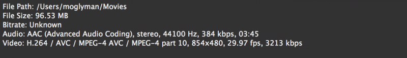

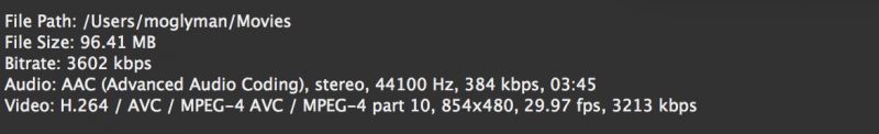

vjmundyPRO InfinityMember since 2014
There is a problem with Mp4 Tag, before in 2073, some mp4 can't be tagged, but now with 2151 can be tagged without problem, sound solved but now these file lose Bitrate field.
Image attached
