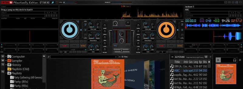

Very strange indeed, I downloaded the VDJ 8 from the site and installed the copy. After installing and running the program it says there is a new update. I download the latest update and the covers do not display on the jogs. I have no idea why. I'm going to reboot my PC and see if that is whats causing this problem. Thanks for all your help and here is a screen capture of whats going on.

Since you're using my skin, you should set the jog display from the skins settings button (next to CPU meter) to "Auto Cover/Slipmat"
Right now you have it set to digital ;)

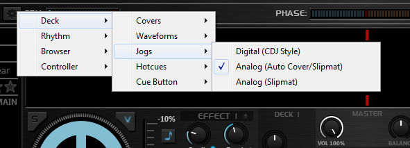

You need to select (from the 'gear' menu button) deck/covers/on and also deck/jogs/analog (auto cover/slipmat).

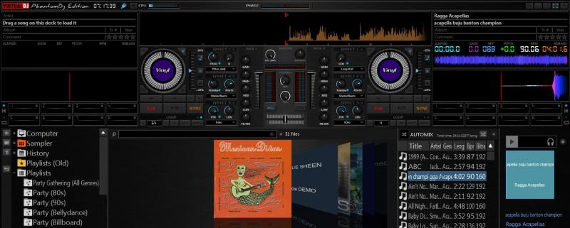

Appreciate your help but it didn't work. When I followed your instructions, my deck now looks like the the capture below. It's still not showing the covers on my Jogwheels even after a reboot. Any suggestions or ideas? This is really strange.

Please try with multiple files.
And as Groovin said you must have "Deck->Covers" option set to "On" as well (but that's the default value)
