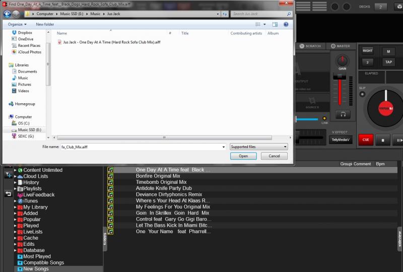

Something also happened in this build where VDJ is now re adding AIFF files that I already have. In this instance below, I know for a fact the file name is not what VDJ thinks it is (shown in the browser. In the last month or so I know every file was "Artist - Song". In the last few weeks, the old DB was erased and I rescanned everything.
Something seemed to have clipped the file names in the DB to the last 12 characters before the file extension. Another note, I did not list the mixes in most of the file names. So it seemed to have combined the Metadata from the song name, clipped it to the last 12 characters and confused it with the file name (see in this screen shot).
![](/image/59012/154547/AIFF 2.jpg)
Posted Mon 12 Jan 15 @ 11:37 am
Are you sure it's not just explorer showing only the right part of the file name?
Can you try to move the cursor to the text box and use left arrow to go to the beginning?
Posted Mon 12 Jan 15 @ 12:52 pm
Odd, not sure why Explorer would do that, but ok. VDJ still thinks it needs to find "One_Day_At_A_Time_feat__Black_Dogs_Hard_Rock_Sofa_Club_Mix.aiff" when the file name is "Jus Jack - One Day At A Time (Hard Rock Sofa Club Mix).aiff" The first VDJ 8 DB was deleted and for build 2094 everything was re added and re scanned.
Well before that build and deleting, in December I changed the file names to get the Artist and Song from the file name (before AIFF tag support). "One_Day_At_A_Time_feat__Black_Dogs_Hard_Rock_Sofa_Club_Mix.aiff" may have been the original file name. So I not really sure how VDJ would think that was current. Especially after both DBs (My Docs and D:) were deleted and the both VDJ 7 DBs were temporarily re located during the re scan of build 2094.
