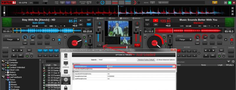

Has anyone had issues with autoHeadphones set to "always" or "onload" and the headphones always stay where they were after loading a song. I have to manually flip PFL to the deck (NS7 has a headphone fader, so I use that).
Posted Sun 07 Dec 14 @ 3:36 pm
So this question is aimed at Atomix. Why does "On Load" (current setting in screen shot) or "Always" not change the headphones? You can see in the screen shot Deck 1 was just loaded and Deck 2 was the Mater, but Deck 2 is also still PFL
I also just uninstalled VDJ 8, deleted the settings XML. Restarted and re installed VDJ 8 build 2073 and set it all up manually again. NS7 - Win 7 64 bit
