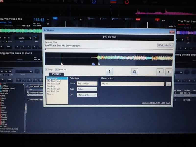

So, I tested this out.
I saved a copy of "You Won't See Mee" by The Beatles as an edit, with "key change" as the remix tag
I then added an action marker at the begining that changes the key up one. Loading the song, it has the regular key until it hits the market, then it goes up one.
Now, I have my settings so that key resets on new song load. If you do not, you may want to add a marker at the end resetting the key.
Posted Mon 10 Nov 14 @ 9:29 pm
