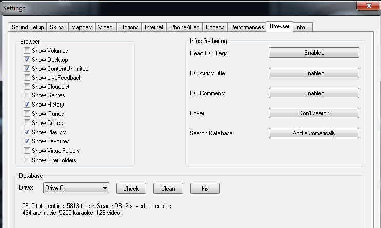

So you're making me go back to 7? Sorry you are having trouble, but this stuff is done automatically. Well, you have to push a few buttons. On the left side of your browser, right click one of your favorite folders, and select add to database. I have provided a pick of my config for you.
On the right you see search database, select add automatically. Any songs you add to your folders, will be added to the database. At the bottom of the picture, you notice the drive letters. This will tell you how many tracks, and what kind of tracks from that drive, are in the database. I also do club and mobile, and need to know the mix I need. Version 8 makes this a lot simpler, as you have more column options, and it will parse the file name for you. There are so many ways for you to filter your selections, you just have to find one that fits you. Filter folders, virtual folders, clean folders, search with the word clean, and a whole bunch of other stuff that I don't even know about. I have way too much content, but keep it simple. I know what mixes I like for certain affairs, and search that folder. Again, 8 makes this a lot easier because you can see these options. As for adding tracks, I add to the folders. If it's a PromoOnly Dance, I add to that folder. JonesTM Latin, Is added to that folder. Beatport just get's added to Beatport, with the year added. I only keep 2 years showing, and the other years, go into Beatport Various.

Looks like I may have to give VDJ8 a try. I deleted the database files and re-added songs from the external hdd to the database tonight. Unfortunately, when I tried to verify the files like you mentioned, and go the the G:\ drive (external HDD), VDJ says there is 52,070 files listed in the db but via windows explorer, there are 52,352 on the disk. Close but I have no idea what songs I might be missing. SO I will upgrade the backup PC to VJ8 and give that a shot.
Posted Fri 17 Oct 14 @ 9:33 pm
It could be that those extra files are non-audio/video files such as cover art, directory info files, Etc.
Posted Sat 18 Oct 14 @ 2:55 am
