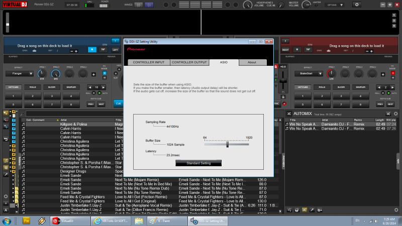

Hey im done with ddj-sz and VDJ8 I have been online for weeks FB and here, I need help or im just returning DDj. I have qosmio x775 with win 8 and 2.40GHz service pack1, 6gb ram, 64 bit i5Intel with nvidia GeForce 560m gtx.
My problem is, when I have in ddj setting utility buffer size set on 256 the vdj freezes for ½ second, and continues to play after, it happens randomly no trigger would not tuch anything, and when I set it up to 1024 Sample I hear every 10,30 sec a pop or a crackle sound if I disconnect my ddjsz and sending sound to laptop speakers everything is fine no pauses or bad sound, please help me!

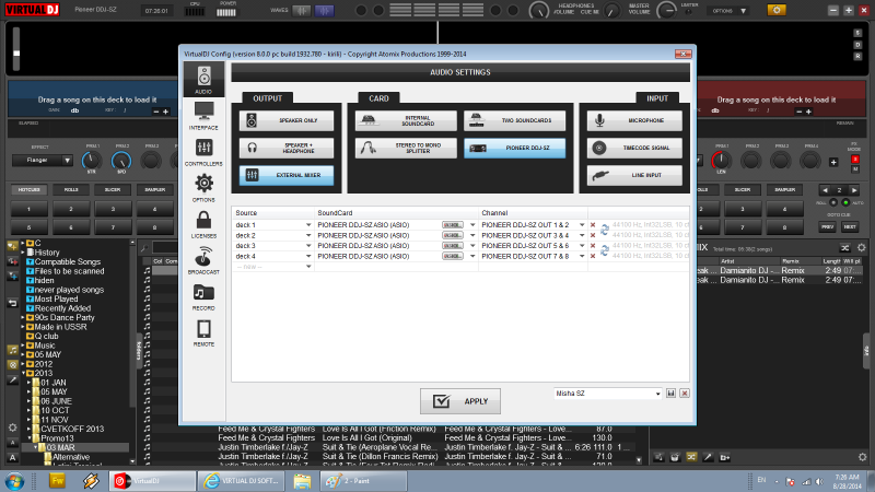

Could you please provide screenshots of your asio driver panel an VDJ sound config?

Posted Thu 28 Aug 14 @ 9:39 am
I'm not sure if this also goes for the SZ, but with the SX you have to choose speaker + headphones.

It's a stand alone 4-channel mixer, and this setup is automatic

Well, as I already suspected... sorry, no further ideas. Wait for someone who owns a SZ.

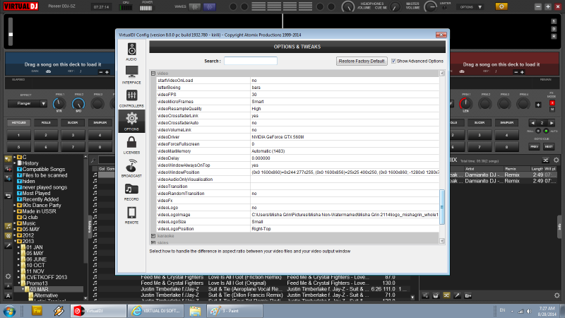

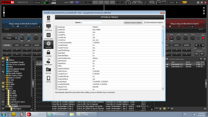

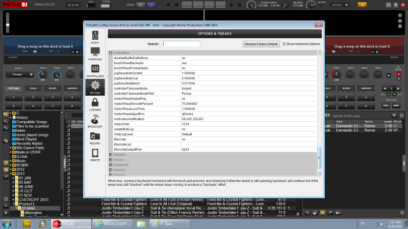

I notice that you have ultraLatency set to "no" and overclock to "yes"...
You should experiment with those. Try overclock set to "no" first. You should be able to get a much lower latency on kit like the SZ - maybe around 10ms or less.
