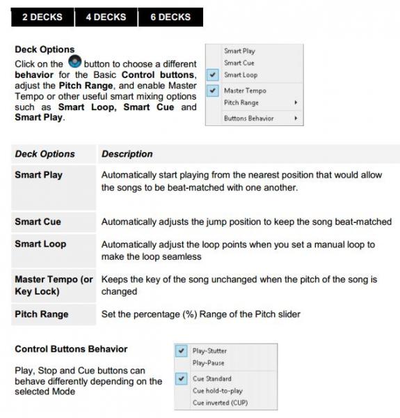

Hi, in version 8 there are several options for the play button and cue button behaviour. Just near the on-screen buttons there is a very small gray/red circle, click that and the options should appear. I'll see if I can get a pic up to show you...
It's all on page 13/14 of the manual :-) http://www.virtualdj.com/images/pdf/VirtualDJ8_User_Guide.pdf
But it sounds to me like you just want to use 'hot cues' (page 16 in the manual).
Hope that helps!
Hope that helps!
