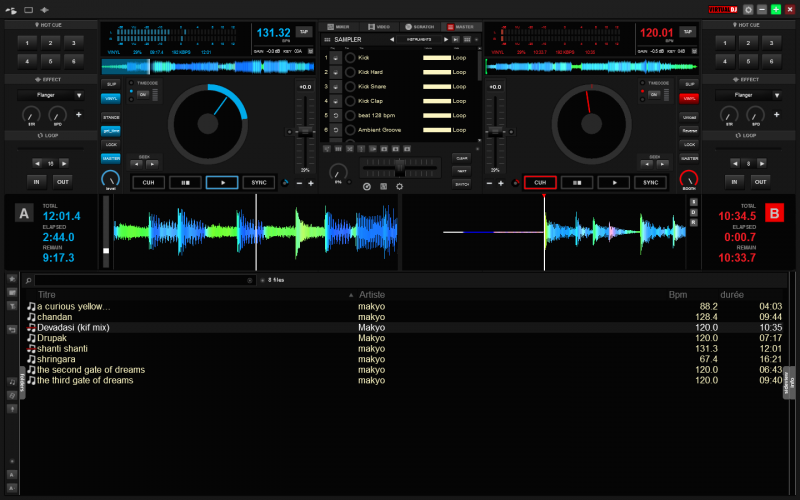

Another great looking update, how do you get the sampler to show in the middle like the pic??
Posted Thu 10 Jul 14 @ 9:38 am
Once you have clicked on the master's tab, it shows a menu instead of the icon in the tab. There you can choose between a few views, sidelist for example. This menu will be extended to show several new things.
Posted Thu 10 Jul 14 @ 9:44 am
