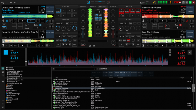

Hi Fruit.
I've switched over to your skin now, from CDS4. I was having some issues with it, ...it being a V7 skin. Here is the configuration I am using:
There are things that I really like, and things that I don't like, about both skins. I also have ideas of my own, having been using Serato and other brands for the last seven years. I would be glad to share my thoughts with you about this, if that prospect holds any interest for you. And, if so, it's a rather lengthy and detailed list. Would you prefer to proceed in this thread, or via private messaging?
