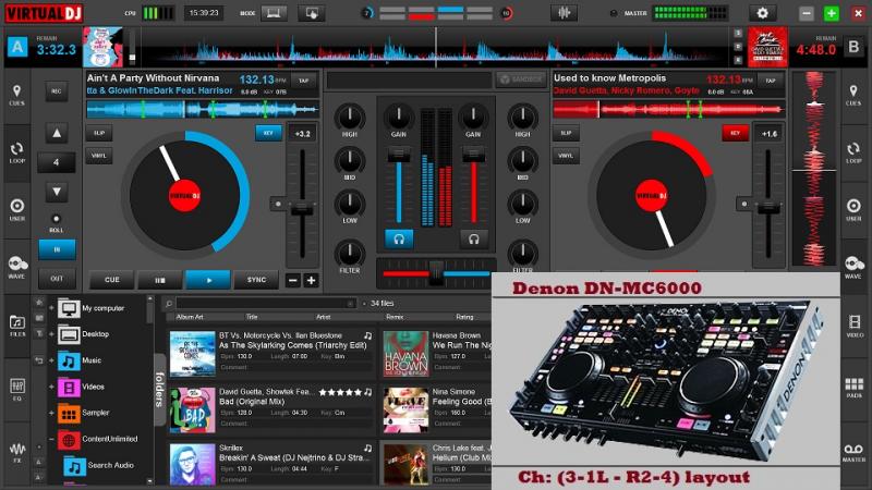

DN-MC6000 Enhanced Controller Mapper v8.0
Enhanced Controller Mapper for the DN-MC6000. VirtualDJ v8 supports (3-1L | R2-4) and (1-2L | R3-4) mixer configurations. This mapper is designed to work with the native DN-MC6000 definition file.
