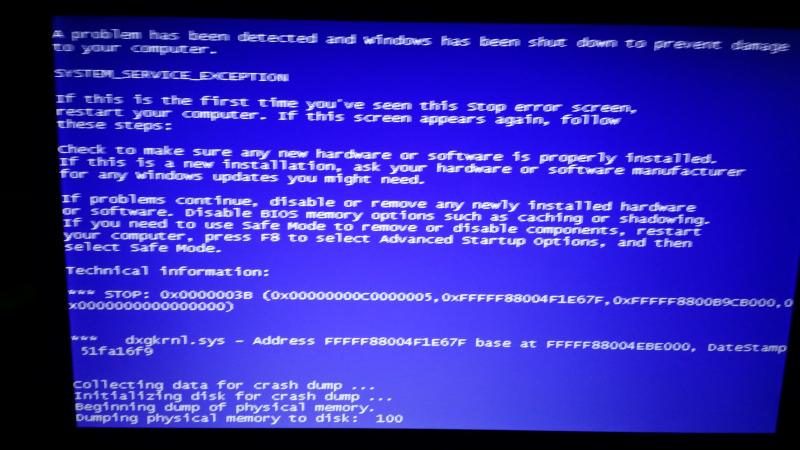

Just started getting this...
Any Help?
Here is details
Any Help?
Here is details

I'm not a Developer - but this is usually driver related and not software related.
Have you installed any new hardware or updated drivers recently?

no brother v7 works flawlessly
Just started doing this

What were you doing when it happened?
Posted Wed 14 May 14 @ 9:00 pm
Video and karaoke
Posted Wed 14 May 14 @ 9:01 pm
Have you been able to re-produce it?
Posted Wed 14 May 14 @ 9:03 pm
Yes it happens everytime kinda wierd
Posted Wed 14 May 14 @ 9:05 pm

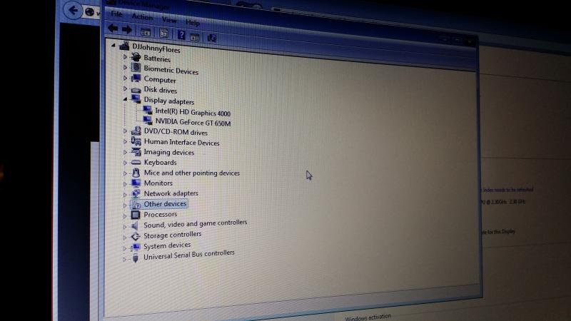

First thing I would recommend regardless of the version of software is to check if you have any updates for your video card driver.
Posted Wed 14 May 14 @ 10:52 pm
Current driver offered
Posted Thu 15 May 14 @ 12:18 am
Did you install directx 9.0c too?
If not, please do that and try to reproduce.
Posted Thu 15 May 14 @ 3:38 am
Can you assist in how to downgrade?
Posted Thu 15 May 14 @ 3:37 pm

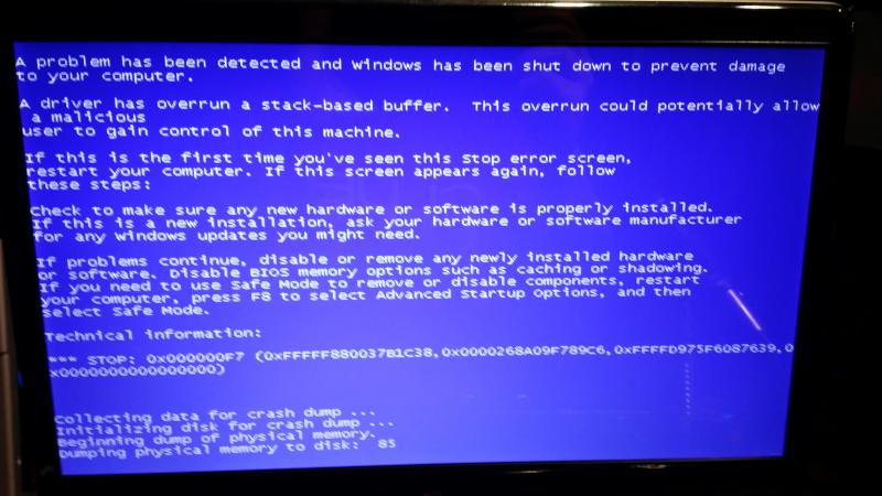

New error just popped up after dx 9 install
Posted Thu 15 May 14 @ 7:54 pm
After DX9 Install and a hour of pounding it.
Posted Thu 15 May 14 @ 8:02 pm
Maybe this will help?
http://repairerrors.net/0x000000f7.html
