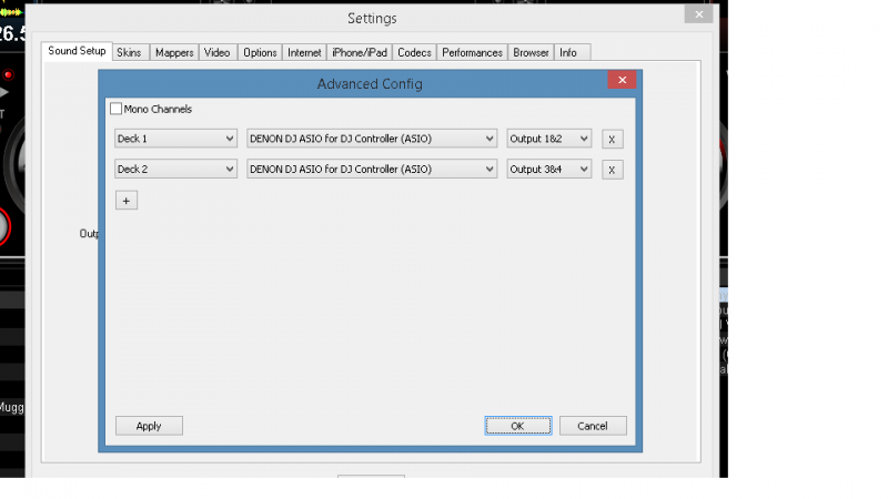

I believe that you must use Master/Headphones instead of Deck 1 / Deck 2 Since the MKII is more a MIDI mixer now than the hardware hybrid it used to be...
Posted Wed 12 Feb 14 @ 3:03 am
gotcha, that seems to work.

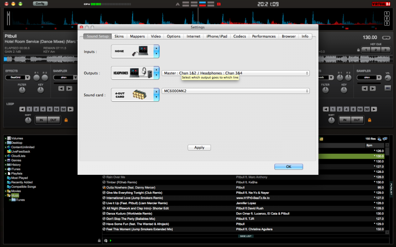

Maybe I am missing something here but I setup the mixer based on how Virtual DJ said to. Now, looking at this thread am I suppose to fix the cross fade issue in Advanced Config or no?
Here is my current setup:
Inputs: None
Outputs: External Mixer - Deck 1: Channel 1&2/Deck 2: Channel 3&4
Sound Card: 4 Out - MC6000MK2
The other issue I have if I do to preview a song on Deck 1 (left side) it will come out of the right side of the headphones. This goes if I am previewing a Deck 2 (right side) it will come out of the left side of the headphones.
I appreciate any help. :)
JP

I have a Mac not a Windows Machine and mine is setup exactly like it is on Page 9. However, the crossfade function is still not working. I have both songs playing and both our coming out of my monitors. See attached also.

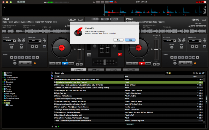

Also, see the attached image. I keep having the issue where it doesn\\\'t seem to be playing but apparently it is. Any idea what that could be?
