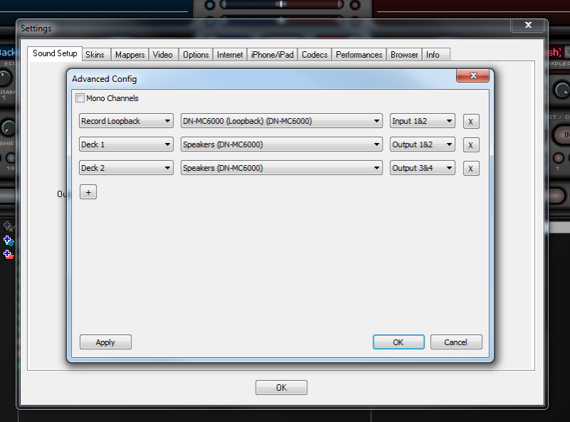

I've used my MC-6000 for broadcasting without issue so my settings should work for you to record. This is for two deck mode:
Use the advanced setup. Set channel 1&2 of the MC-6000 sound card to Inputs 1&2. Repeat for channels 3&4.
Now the important. Set the Record Loopback to the inputs of the MC-6000 sound card.
That should do the trick...

Here's the set up:
On the back of the unit:
In the advanced config:

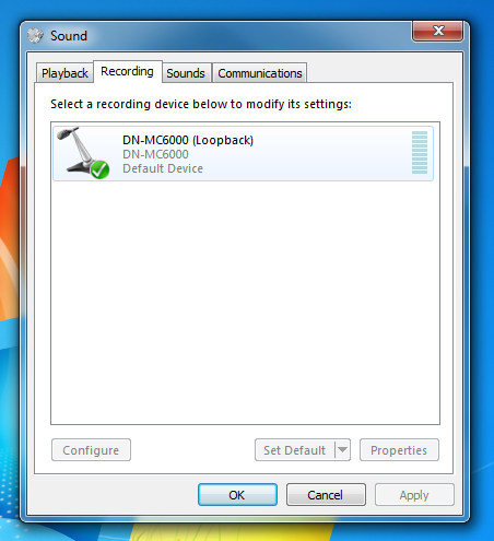

I broadcast internally using Shoutcast but also use BUTT (http://butt.sourceforge.net/) for recording the podcast so I hook BUTT up to the DN-MC6000 (Loopback) which appears when the unit is plugged in and turned on.

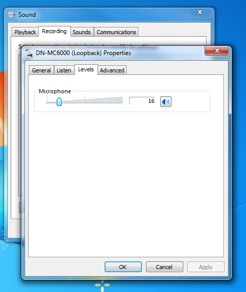

You'll notice the levels are quite low - 16 works well. I then adjust the gain per track somewhere between 45-55% usually.
Note: The master volume has no impact on the loopback. This is coming back directly via the USB.

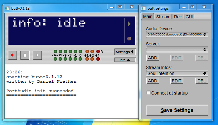

Finally the settings for BUTT. As I said I'm not broadcasting with BUTT as I'd have to manually change the track/artist infor which Virtual DJ does so well ;-) but you should see the Audio Device is the Denon loopback.

Here's the set up:
- PC
- Mixing Mode - Int Mix
- Output Source - Rec Out/Mic
