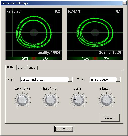

Still looking pretty good. The only issue I can see for now is that the visual display of BPMs in the software fluctuates up and down slightly once adjusted on the TT (eg if bpm was increased from 113 to 115 then you see 114.6...114.8...115.0...115.2...115.0...114.8...114.6 etc.) . The actual waveform and beat of the song seems to be maintained which is the main thing. Here are some screenshots as requested:
timecodesettings.JPG" class="bb-img">
Posted Thu 03 Nov 11 @ 7:22 pm
That little fluctuation in the bpm your seeing is because our tables don't maintain a constant speed, they don't rotate at perfectly. I to have this but as you've seen its nothing to worry about. Listen to your ears cause they'll never let you down.

I'm currently not able to post screenshots but I'll try to describe my settings.
First, I'm using Technics 1210 MkII with Technics headshells and Shure M44-7 system.
An audio 4 dj connected to the techs and to a vms4.
vinyls are this one ( I guess these are the ones you ment by saying "the new ones").
http://www.musik-service.de/images/prx/395760440/i00.jpg
In VDJ I use pretty much the standard settings. Same for the audio 4 driver panel.
In the timecode settings I just adjusted the params to fit my signal into the "four squares" and silence at ~8.00 o'clock.
Thats it. Works perfect for me :)

Hay I'm just wondering if you could help me. Just to let you know, I officially have all my gear. Now, as you'd expect, I can't seem to get the time codes to run properly. I've nearly succeeded in having them running well together however when I move the pitch from average and leave it the pitch seems to start jumping all over between ruffly 1bpm or so. Also, I can't seem to get both decks running nearly perfect together, I seem to only be able to handle one deck at a time, and then I am unable to make the other deck match. I'm almost certain that it's signal noise what could be upsetting it, but I am not sure how to stop it if so if it's the case.The circles seem small too, does that matter? Sometimes the audio glitches when playing. It has sometimes been the case when playing it, it runs nice along with those small problems, and spazzes out when I stop the vinyl. All this has been driving me crazy, especially with all the wires and mess, I've been so tired when I returned home so I'll make another attempt on it on Saturday I guess. =)

Can you upload pictures of your timecode config screens? Use ImageShack or something like that then post a link. Also what is your gear??

when you go into the signal window, remember that you can seperate the individual decks if you click on "line 1" "line 2" that way you can have different settings for both, a couple of the pics here have one good and one not so good signal

These are my settings for the 2nd deck, this is one that won't work when I've tuned 1 remaining one which works nearly find. Now I don't know if it's to do with 2 sound cards interfering with each other, or if it's something which is coming from just a deck. Maybe something simple? However it gives me back ache trying to sort it so I keep giving up and then going back to it.

The first thing I see is that your gain is turned all the way up. I've never used those soundcards so I don't know how well they work, but since there the same I'd imagine it should work. I know when using 2 different types of cards you can run into problems.
You say you have 1 table that works great, have you hooked up the problem table to that card? If both tables work on that one card I'd say something is wrong with the other card. Post a screen shot of the working table.

I know with the gain, it's really stupid. I was just showing how loud it needed to be for the circle size to show up, which is not the same on the other deck. =S The sound cards suck **** I wish I was patient now and saved for the Maya44 =(

Near enough sorted it now guys! =D I had a circle on the screen and it kept molding inwards which I couldn't understand like ever 2secs. So I began to watch the vinyl spinning, I thought to myself maybe the way the needle is picking up the pitch has something to do with it, this was some time after moving my cables around to get rid of the humming. At first I thought it was the angle my turntable which was casing this but nothing changed when I moved it. So I unscrewed my needle cartridge and to my surprise I saw a whole collection of fluff and dirt which had collected from the vinyls in which I was trying out. I picked it off and blew them and the circles was nice and clean, the other deck was the same, with the dirt, and now they don't jump everywhere.
However, my pitches seem to still change on a track load, by 5% or so which I don't quite understand, from what I remember the pitches don't jump around like I previously mentioned when playing but seem to change on load or something. I may have to still tweak around for that.
The sound quality sometimes goes all horrible, and all bitty/fuzzy but I think that may have been solved since I clicked 'safe mode' in my settings, may have saved all the glitchyness.
