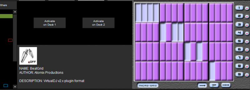

I've been searching everywhere on here and it seems like no one knows the original default pattern.
If someone does know I would appreciate it so very much.
Thanks in advanced!
Added by SBDJ for clarity:
This is the original Beatgrid preset 1 which is what most people will want:
D=DOWN
U=UP
DDDD UUUU UUUU UUUU
UUUU DUDD UUUU UUUU
UUUU UUUU DUDU UUUU
UUUU UUUU UUUU DUUU
Failing that BeatGrid.ini should look like this:
Thanks in advanced!
D=DOWN
U=UP
DDDD UUUU UUUU UUUU
UUUU DUDD UUUU UUUU
UUUU UUUU DUDU UUUU
UUUU UUUU UUUU DUUU
[Preset1]
MicroGrid=1
Mode=0
Grid=0000000000000000000000000000000001000000FFFFFFFF010000000100000002000000FFFFFFFF02000000FFFFFFFF03000000FFFFFFFFFFFFFFFFFFFFFFFFF2
[Preset2]
MicroGrid=1
Mode=0
Grid=00000000FFFFFFFFFFFFFFFFFFFFFFFF01000000FFFFFFFFFFFFFFFFFFFFFFFF02000000FFFFFFFFFFFFFFFFFFFFFFFF03000000FFFFFFFFFFFFFFFFFFFFFFFFD6
[Preset3]
MicroGrid=1
Mode=0
[Preset4]
MicroGrid=1
Mode=0

Just delete beatgrid.ini from the SoundEffect plugins folder whilst VDJ isn't running.
Posted Wed 08 Dec 10 @ 11:39 am
Didn't help. I just really want the original config as one of my beat presets.
Posted Wed 08 Dec 10 @ 11:49 am
OK:
D=DOWN
U=UP
DDDD UUUU UUUU UUUU
UUUU DUDD UUUU UUUU
UUUU UUUU DUDU UUUU
UUUU UUUU UUUU DUUU
D=DOWN
U=UP
DDDD UUUU UUUU UUUU
UUUU DUDD UUUU UUUU
UUUU UUUU DUDU UUUU
UUUU UUUU UUUU DUUU
Posted Wed 08 Dec 10 @ 6:13 pm

Click on the MICRO-GRID button (Effect page->Sound effect tab->beatgrid)
Posted Thu 09 Jun 11 @ 9:59 pm
It transpires Preset1 was missing from my beatgrid.ini. You should be able to select the grid options as described above and when happy save the options using the small circular buttons on the right - most of us will just want to use the upper right button.
Alternatively you can copy the text below into your beatgrid.ini file....
[Preset1]
MicroGrid=1
Mode=0
