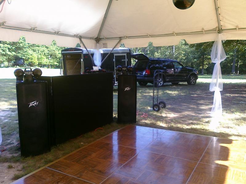

I can hide just about anything behind my mobile booth... coolers, women, cables, crates etc... Not the best pic but you get the idea.

OK I may be alittle off base here but what does the picture of your setup have to do with this thread ???? Hmmmmm ?
This thread is about using a 50 ft video cable ???? correct ?

yes you are correct, this thread is about running a long cable to a projector. If you will read the post before I posted the picture you will see that the poster was concerned about concealing the remainder of a 50' cable if the projector was say 30' away. My post was to illustrate how a booth or cover is a attractive way to conseal the remaining footage of cable.

OK, that conseals about a 15 foot span, how about the other 35 ft ?
By the way nice setup, looks very neat.
Posted Mon 22 Nov 10 @ 6:40 pm
you can't in a mobile situation, you can only conceal so much and make it as safe as you can for trip hazards and damage, when in a bar or club enviroment that's when you are able to conceal cable runs a lot more.
like most people rob elects like myself to hide any excess cable at the business end of things (the decks), although i still see mobile guys stuffing lighting and audio leads under their respected stands, looks bloody awful.
