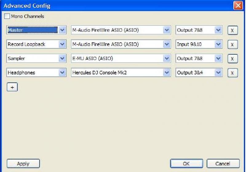

to record mic or line in, choose ADVANCED SOUND CONFIG, in the 2nd drop down in souncard settings.
Then set your deck outputs, and last add RECORD LOOPBACK, with mic or line in input
Thats it ;)

it should looks sth like this :)
Posted Mon 18 Oct 10 @ 8:41 am

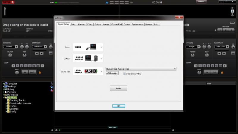

I too had the same issue using a line in to record my karaoke singers. My problem is that if I use the advanced config setting my sound sounds crap because I need the \"ultra-latency ASIO\" box checked on my laptop, which can\'t be done in advanced config.
Has anyone got a solution on this please?
Posted Fri 03 Jun 11 @ 6:06 pm
I'm not a 100% but I think if you check the ultra low latency before you go into advanced config it'll work. Now that I think about it should work. There has been times I needed to change the latency of my soundcard and I had to come out of the advanced config change the setting and it worked.
Try it and let us know

JoeyKJPRO InfinityMember since 2008
You need to do this in advance setting, not the way you have it in the image.
The "Output" channels of your sound card has to also the "Input" channels of the "LoopBack" channel, something similar to the fourth post....

update .....it won't let me use mic input in the regular sound config , i get the error in the asio soundcard message
here's the advanced config......
deck 1 speakers (Hercules DJ Console RMX) OUTPUT 1&2
deck 2 same as above , but output 3&4
record loopback Microphone (USB Audio Device) input 1&2
Posted Sat 04 Jun 11 @ 4:04 pm
aahhhh got it......
here's what worked .....
in advanced config
Headphones Speakers (Hercules DJ Console RMX) output 1&2
Master Speakers (Hercules DJ Console RMX) output 3&4
Microphone Primary sound capture driver input 1&2
in mixer console , turn the Master deck down a bit , mic up all the way
in windows mixer give primary driver a little more volume (oops)
many thanks .... i will almost never call you wimps , wimps , you wimps
next get a usb mic that didn't cost 20$ ........
see .... advanced config IS the greatest thing since fishnet stockings
Posted Sat 04 Jun 11 @ 4:45 pm
