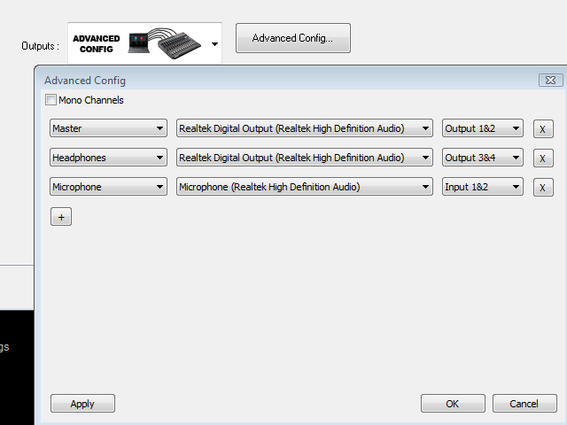

When I go to advanced config I can select all the right channels as you have described above and I get ouput of sorts. The onboard soundcard for the master puts out music, but with a crackle, the USB soundcard (Behringer UCA202) plays cue perfectly, but the mic comes over the speakers with just crackle. No voice at all.
Posted Tue 19 Oct 10 @ 7:21 am
Same thing I get but different soundcard, I'm using a Maya44 and my onboard is a Realtek HD. It sound all robotic. Must be close though cause the sound is passing through.

Hi there.
Below is a screeshot of my usual setup:
Here is how it looks if I select Mic input - I can no longer use 2 soundcards
And here is the Advanced Config setup that has all the channels correct, but fuzz over the music in master output and total buzz from mic input. It\'s not the ports or channels. Audacity picks up my mic just fine.
Posted Wed 20 Oct 10 @ 8:18 am
