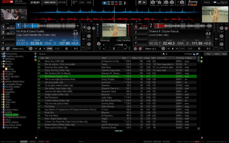

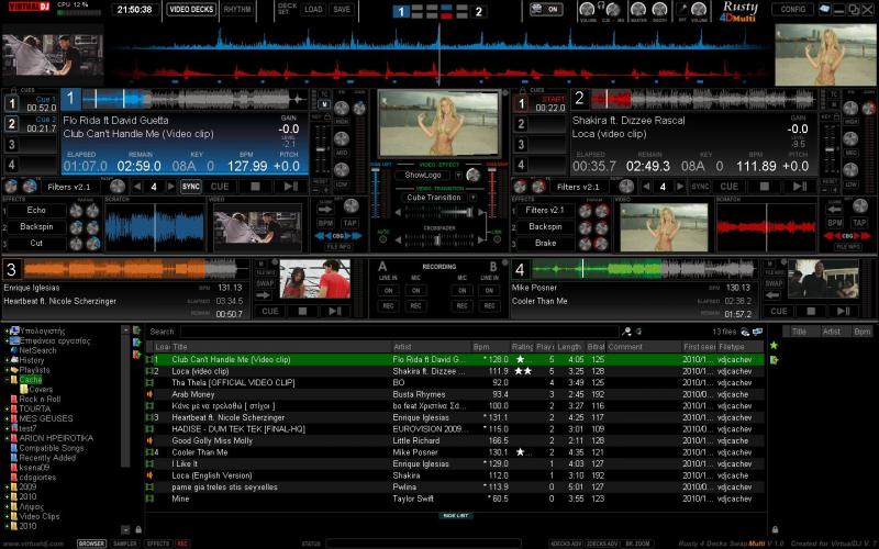

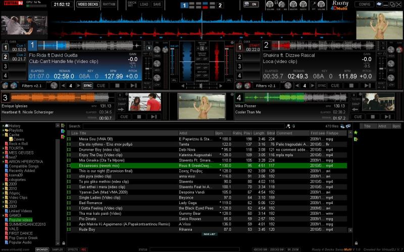

The skin has the Left-Right logic ..you will get used to these new terms..hehe
Resolution 1440X900
You can control 4 decks (or 2) with just 1 controller, a 2 channel mixer and a simple 2chan sound card.

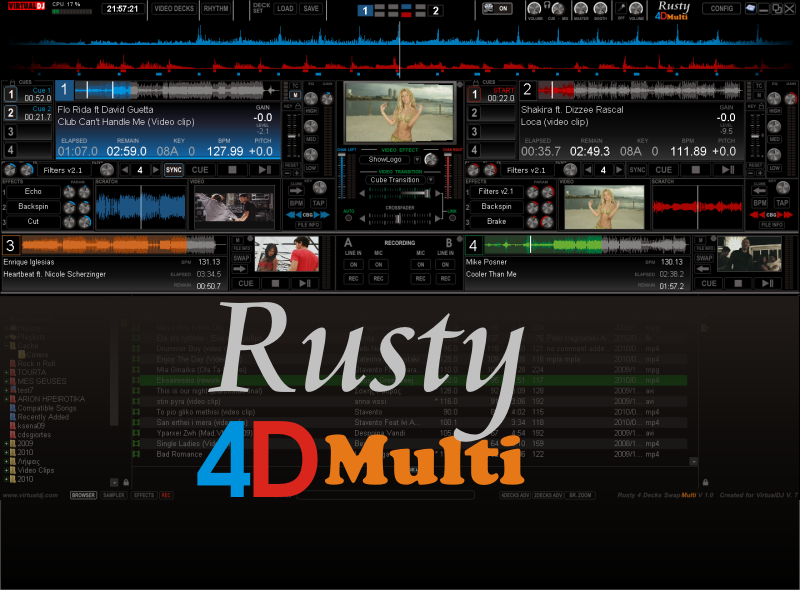

You have 2 main decks (left & right) and 2 auxiliary, but you can Swap them any time with the Swap skin button or a shortcut (i will post later the syntax)
You will notice 6 Main different Pannels (Screens)
- 4 Decks Advanced Mode
- 4 Decks Simple Mode
- 2 Decks Advanced Mode
- 2 Decks Simple Mode

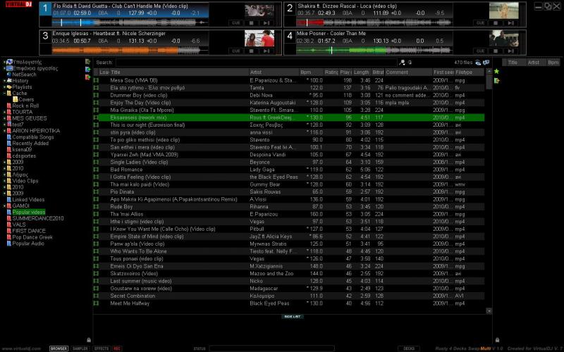

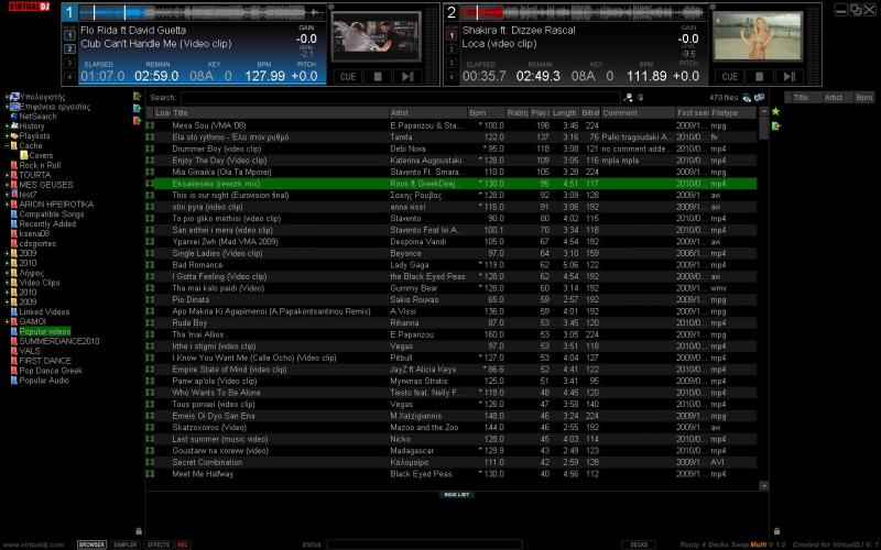

- Zoom Browser with 2 mini decks (if you are using just 2 decks)
- Zoom Browser with 4 minidecks (if you are using 4 decks)
Very easy and smart navigation ! If you are in a 4 deck pannel Zoom Browser goes to 4 mini decks.
Enjoy MULTI simplicity !

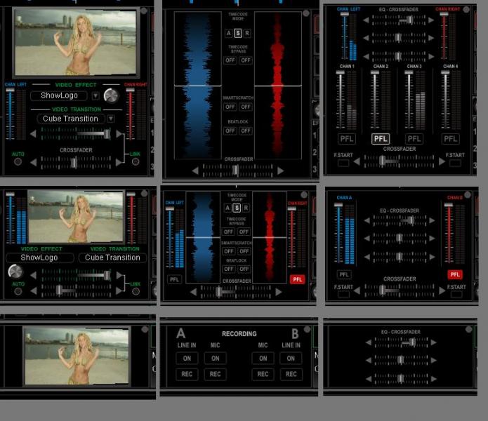

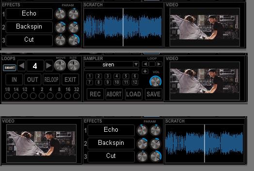

Each Advanced Deck has 3 small panels which you can make them look as you wish. Click on the Panels titles and you can have many different views. (5 different views for EACH pannel Sampler, Loop, Effect, MiniScratch, Video)
The picture shows just 3 of the numerous choices you have..

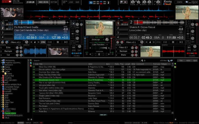

The skin has
- 3 different Large Center Pannels (for Advanced Mode)
Audio Mixer - Video Mixer - Scratch panel)
- 3 different Small Center Panels (For Simple Mode)
- 3 different Mini Center Pannels (For 4 decks modes)

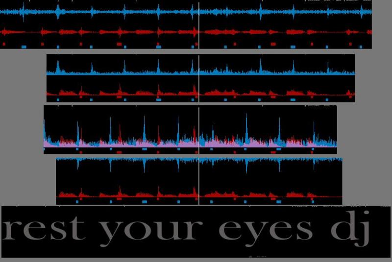

Skin has 4 different Rhythm Views + 1 my favorite (you may guess which one... hehehe)

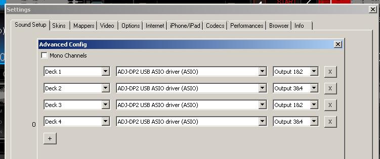

Sugested Sound Config ..
Just copy-paste those and play with them...
Shortcut1
deck 1 leftdeck ? deck 3 leftdeck & deck left select & deck 3 leftvideo & deck 3 leftcross 'only' & deck 3 level 100% & deck 1 level 0% : deck 3 leftdeck ? deck 1 leftdeck & deck left select & deck 1 leftcross 'only' & deck 1 leftvideo & deck 1 level 100% & deck 3 level 0% : deck 1 leftdeck & deck left select & deck 1 leftvideo & deck 1 leftcross 'only' & deck 1 level 100% & deck 3 level 0%
Shortcut2
deck 2 rightdeck ? deck 4 rightdeck & deck right select & deck 4 rightvideo & deck 4 rightcross 'only' & deck 4 level 100% & deck 2 level 0% : deck 4 rightdeck ? deck 2 rightdeck & deck right select & deck 2 rightcross 'only' & deck 2 rightvideo & deck 2 level 100% & deck 4 level 0% : deck 2 rightdeck & deck right select & deck 2 rightvideo & deck 2 rightcross 'only' & deck 2 level 100% & deck 4 level 0%
As you may notice those 2 shortcuts automatically makes the swapped deck selected and left , makes it leftcross (crossfader assign), makes it leftvideo (videocrossfader assign) and mutes the other one, so in other words you dont make anything else, just play !
