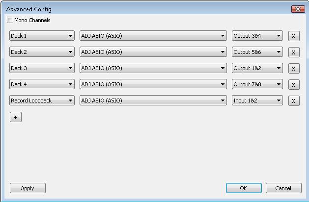

I need to post this.
Heiko was right about the setup for recording. There is no need to route any cables in order to record with the VMS4. All you have to do is add the RecordLoopback in you sound setup. This way the mic is also recorded.
Turn also all you ch to USB from and the VMS4 to 8out mode in order to control 4 decks with VDJ.
This is the sound setup.
My apologies for the confusion.
Posted Fri 14 Jan 11 @ 7:38 pm
triggers100 wrote :
will this setup also enable me to broadcast with the virual dj setup ?????
all i need now is the ability to play on internet radio with the mic and 4 decks, i have tried routing back into the pc line in and useing winamp or simplecast to connect but they both have a start/stop function to connect unlike the vdj connection where you can keep pressing start untill you are connectied on winamp and simplecast you have to start then if you miss the connection you have to stop then try starting again. unfortianatly this causes problems with timeing of conections...
if this is not possible can anyone recomend a shoutcast broadcasting software that is easyer to connect to the station i use
thanks
fix
Posted Tue 25 Jan 11 @ 12:28 am
Yes, this setup will allow your to broadcast directly through VDJ's own shoutcast interface.
The Record Loopback brings the Mic and any analogue inputs back to pc via the usb cable.
Test it yourself, by using the shoutcast server option within VDJ, where you broadcast from your own IP. Then use another PC or get someone else to listen on the info VDJ gives you to prove it.
Cheers,
Roy

thanks for your reply roy....
iv tried this setup and for some strange reason when i put in that last line to the settings i already had the decks dont play and when i try to change back virtual dj freezes up ????
im useing the mapper and skin by dj dad and my settings are for 4 decks, 8out and the firmware is 3.11
im also useing the internal sound indicated by a 0 at the start of the device number
do you think this may be a problem with the vms4 or maybee my vdj setup???
would realy like to sort this out as the virtual dj internal broadcast works first time all the time :)
thanks again

was thinking do i need to add anything to the asio setup aswell to get it to work??
my setup is same as the audio interface mode 8 out mode in the manual
trying to get it sortied before my radio set on friday
thanks for any help
fix
thanks for any help
fix

With the above setup, are you able to record properly? Remember there is no need to route master or booth to some linein. The routing is internal.
If record works, then broadcast should work too.
Posted Sat 05 Feb 11 @ 6:30 am
cant get either to work as the whole setup freezes when i put the record loopback line into the advanced setup
both onscreen and mixer fuctions fail to work and i have to reset vdj then remove the record loopback line to get it working again

What have you mapped record Loopback to?

djdad wrote :
this is the way the recorded loopback was mapped, as i say iv got the mapper running 8 out and with the 4 deck skin, but as soon as i add the recorded loopback line into it the whole thing freezes up
thanks
