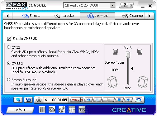

Hello djdigitalduke,
In EAX console, you must disable the CMSS 3D effect.
