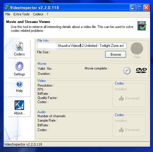

Hi!
Still not work, this is how it looks:
http://i302.photobucket.com/albums/nn85/Freddeme/aviproblem.jpg?t=1239742623
What can i do ?
Like i said, some avi-files work and some not.
Thanks in advance :-)
/Fredde

Maybe it's a codec that videoinspector doesn't recognise, try mediainfo
Posted Tue 14 Apr 09 @ 7:12 pm

Looks like they could be corrupted in some way, the thing is that at present there are so many confusing codec varations around that it occasionally happens, the advice re mpeg above is correct, but if the files are corrupt then a converter wont be able to read them. Do they play in VLC media player, VLC will play practically ANYTHING.
Posted Wed 15 Apr 09 @ 9:19 am
Hi!
No, thats the strange thing, thoose files that VDJ cant read, cant either VLC read/play, so im guess the are in some way corrupt.
Posted Wed 15 Apr 09 @ 9:21 am
I think you're guessing right.
Posted Thu 16 Apr 09 @ 5:10 am
