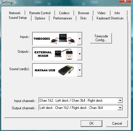

EQUIPMENT
VDJ Software: http://www.virtualdj.com
Maya 44 USB esi: http://www.audiolines.com/product.php?productid=20852
Technics SL-DZ1200 Turntables (QTY2): http://www.panasonic.com/consumer_electronics/technics_dj/prod_intro_sldz1200.asp
Technics SH-MZ1200 Mixer: http://www.panasonic.com/consumer_electronics/technics_dj/prod_intro_shmz1200.asp
Time Coded CDs (PRO): http://www.virtualdj.com/products/timecode/VDJTimeCode_pro.mp3
Setup for the above components WILL work with Virtual DJ.
Setup Maya 44 USB:
(KEY: 1=Left Mixer Channel and Turntable, 2=Right Mixer Channel and Turntable, r=Red, w=White)
(MIXER) -- (TURNTABLE)
11 -- 22 -- 11 -- 22
rw -- rw -- rw -- rw
Maya 44 USB esi Drivers for Windows Vista: SOLID!! Worked Perfectly!! Only complication I have is that I always need to use the same USB port, otherwise VDJ does not see the Maya 44 USB device. <-- I'm sure this can be easily correct by reloading the drivers on another USB port, but I'm too lazy to mess with that :)
VDJ Functionality with Maya 44 USB: Slight lag, but nothing to cry about... Definitely less expensive than Serato. (Serato does have the least amount of pitch control lag,.. between the various devices I have used.<--tested various devices with the same laptop). Maya is definitely more efficient than loading CDs into the Extremely slow loading Technics Turntable.
Laptop Specs (if curious): Dell Latitude 620, Duo Core 2.0GHz Processor, 4GB RAM, 7200RPM HD.
Best Part of VDJ and Maya 44 USB: VDJ WILL still push the sound effects, samples, loops, ect; to the correct devices. In other words, you do not lose any of the additional features of Virtual DJ! (Side note: Create loops using the numbers at the top of the keyboard, don't try to loop using the In/Out buttons on the Turntable... well you can, but it's not the cleanest and can be unpredictable).
In Closing: I hope the information provided here will help others in their quest of finding an MP3 Solution. I spent months trying to figure out the correct route for the above setup. My biggest fear was losing the addition features VDJ provides. I was torn between the 2, 3, and 4 Channel sound card. Blogs mentioned that I would need the extra channel to push the sound effects down. Luckily I made the correct choice, the two channel sound card. In my opinion, Maya 44 USB esi is an Excellent and Inexpensive solution for pushing MP3s from Virtual DJ to an Analog Turntable and Mixer.

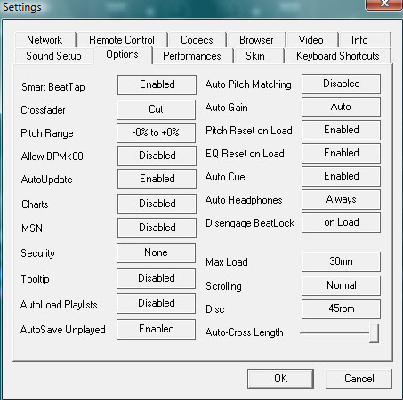

Sorry for the extremely late post; I've been meaning to add this for the last couple of months. The Lag I found with the sound card and software was more of a user error than anything. In the Virtual DJ Config -> Options Tab, I mistakenly left the default Pitch range settings (+/- 33). I was not experiencing lag, I was experiencing EXTREME over compensation. My Technics pitch is set for +/- 16, and the VDJ software is set for +/- 8, which works great!!
I have attached 2 photos of my current settings.
(btw.. I shoudl be upgrading to Windows 7 in the near future; at that time I will be updating to the latest version of VDJ. If I run into any Asio driver issues I will add aditional information below.)
