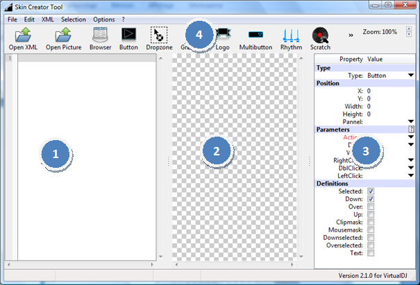

When opening the software, you first get a splashscreen and then the following window:
The main interface is divided in four zones
  1. XML
    The XML code for the Skin will be displayed in this part
  2. Picture
    This part displays the picture of the Skin. User can zoom in and out with the mouse-wheel.
  3. Property List
    This part presents the list of properties available for each Skin element
  4. Toolbar
    Most used commands (Open/Save file, Skin Elements) are displayed in the Toolbar.

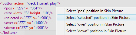

Showing Skin element in the picture
In order to show the position of an element on the picture, and to load the properties in the Property List, select the entire block of text of an element.
If you need to show another position instead of the default position (such as “over”, “down”, “clipmask”), select the skin element and then right-click in the XML zone.
All element positions will be available in the right-click menu.

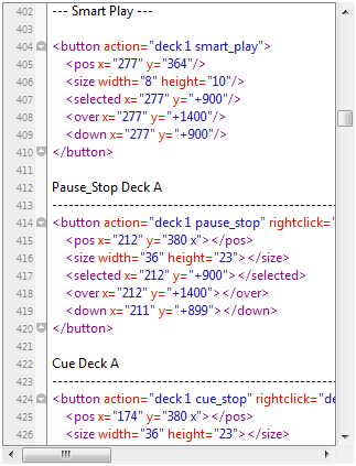

Bookmarks
If you are often going back to a Skin element or you wrote a comment on a line and need to access it quickly, you can bookmark a line.
The easiest way to bookmark a line is to click on the left of the line numbers (the blue zone in the picture). You will then get a red arrow next to the bookmarked line (line 407 is bookmarked).
To un-bookmark a line, click again.
You can access all bookmark options in the right-click menu.
Available options :
  • bookmark/un-bookmark a line,
  • quickly go back to a bookmarked line
  • clear all bookmarks.
