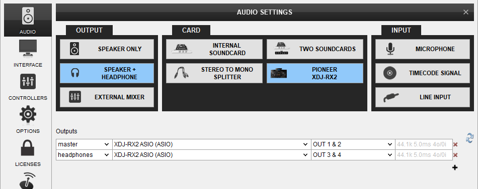

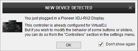

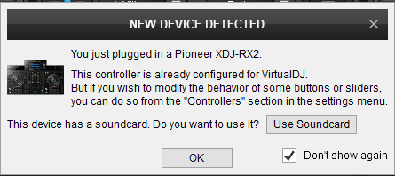

2 detection windows will appear right after, verifying proper connection. Have your speakers connected to the rear-panel of the XDJ-RX2 and click "Use SoundCard" for VirtualDJ to apply the pre-defined audio setup with the built-in sound card of the XDJ-RX2 You can still change that from Settings->AUDIO tab.
Click to OK on both windows

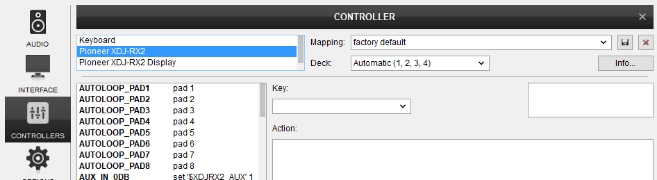

The unit should be visible in the CONTROLLERS tab of Config as 2 separate units (one for the main unit and an additional one for the Display) and the “factory default” available/selected from the Mappings drop-down list for both units. The factory default Mapping offers the functions described in this Manual, however those can be adjusted to your needs via VDJ Script actions.
Find more details at http://www.virtualdj.com/wiki/VDJ8script.html
AUDIO Setup
The unit has a pre-defined Audio setup and a special button in the AUDIO tab of Config to provide that.
Alternative audio configurations can be applied See Advanced Setup
