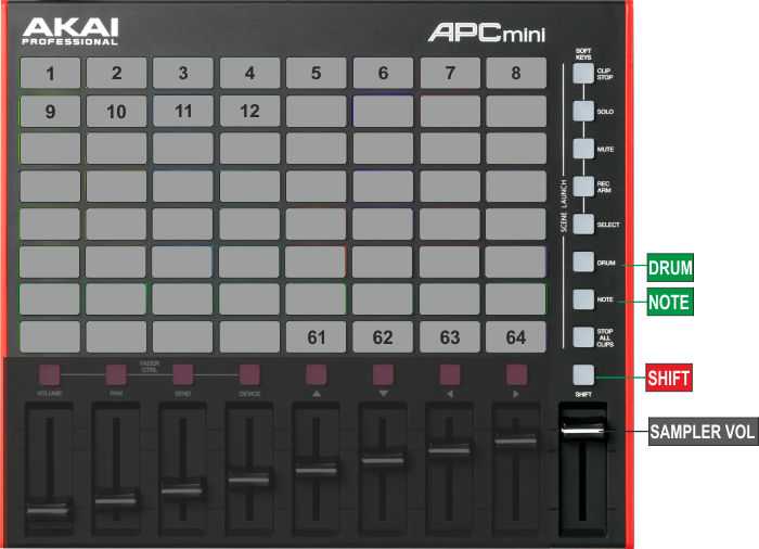

DRUM MODE
Hold SHIFT and then press the DRUM button to get the Drum mode (hardware layer). This mode has been assigned to offer VirtualDJ Sampler controls.
KEY
ACTION
PADS 1 to 64
Trigger the Sample 1 to 64 of the selected VirtualDJ Sampler Bank. The RGB leds of the Pads will get the assigned Sample color and will blink when playing.
CLIP STOP
Select the previous available Sampler Bank.
SOLO
Select the next available Sampler Bank.
MUTE
Select the On/Off Sampler Trigger mode.
REC ARM
Select the Hold Sampler Trigger mode.
SELECT
Select the Stutter Sampler Trigger mode.
DRUM
Select the Un-Mute Sampler Trigger mode.
Hold SHIFT and use to toggle between Pads and Drum modes
NOTE
Unassigned. Hold SHIFT and use to toggle between Pads and Note modes
STOP ALL CLIPS
Stop all currently playing Samples.
FADER 9
Adjust the Master Output Volume of VirtualDJ Sampler.
