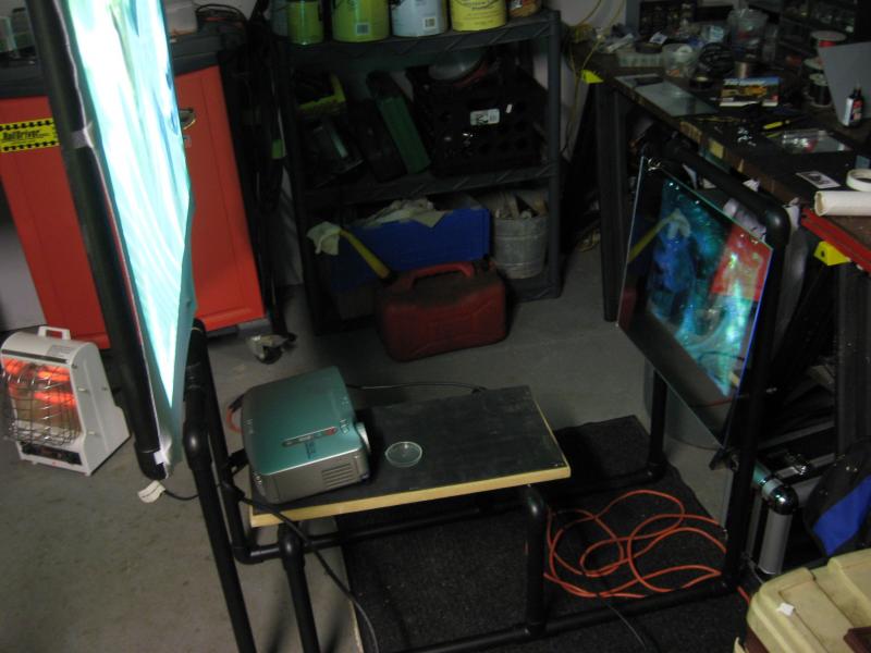

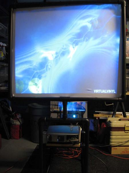

Here is what I made for small space projection in case you havnt seen it yet.I will post a pic when I remember to bring a camera next time.
Total depth of pvc frame is 3ft from back wall and refecting projection image off an acrylic mirror to a 45inch x45inch screen.Stll bigger then an LCD screen tv.

Hey Lineman how does the spandex scrim show up in ambient lighting conditions?
I've been researching screen material to add a projector to my set up and essentially Spandex is the stuff that djscreens.com stuff is made out of.
The manufactured rear-projection stuff is greyish coloured stuff and it has advertised gain-amplifying properties.
Just checking in with the guys with the homemade stuff, how does it work with the hall's lights on?
When the lights are lowered in the hall, I don't have any worries

NEMAN55,
That looks really cool and not so expensive.
With this setup you don't have people walking between the sceen and the beamer.
Guess that this would be great for a lot of people.

The spandex material I use here was bought at a local fabric store and is not the same thickness as DJSCREEN because I have that screen also and use that for larger gigs where room is available.It works real well considering the unit is used for small venues with everybody being able to see it very well from across two dining rooms with the lights on.Its not a hall per say but the lights are on for the duration.
You will get a hot spot if you get up close.The mirror is angled up just a bit to reflect back onto the screen.Mine will be seen if you get up close and look down somewhat into it.
If you are familiar with the term hotspoting (where you can see the projector light through the screen) this will happen with this material.
Proper rear projection screens wont allow that.
Other then that it works excellent and brings the curious up for closer looks every time I use it.
Definitey go with a high lumens 2000 or better.
