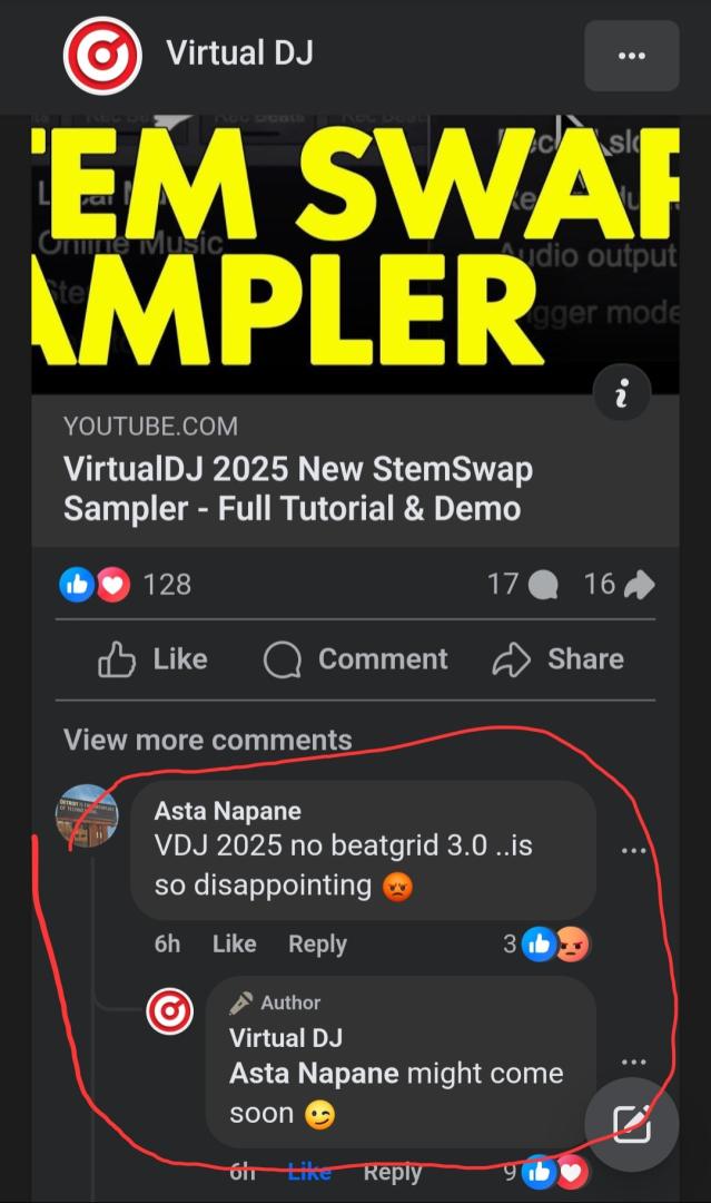

However, with respect this topic here was a little whisper about it in the Facebook group:
That should put your mind at ease. Be patient...they do know this is important to many.
