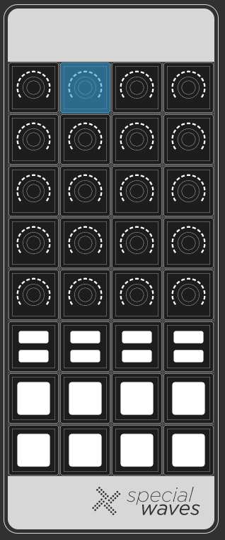

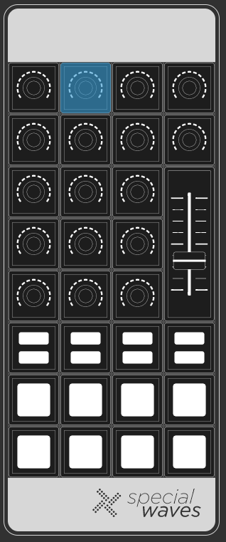

Hi,
below are my finished files for mapping the Special Waves Mine-S Controller.
Let me first explain the workflow and my use case:
My motivation was to get a controller for all stems. I wasn't sure how exactly I will work with stems in the future, although I already played several gigs where I tried two controllers (that I then returned - they didn't fit):
So my main use case is to:
Currently, I like most the individual stem control. Maybe in the future, I will want to use something else. I am using an old CDJ-850 to control the deck 3 and there I also wanted Pads (same as on controllers). I documented the mapping of CDJ-850 at https://www.virtualdj.com/forums/245887/VirtualDJ_Technical_Support/Resolution_ot_various_issues_with_Pioneer_CDJ-850_and_a_few_more_enhancements.html )
There is a secondary use case, that I need to explain here. My files already contain definitions for an additional slider that I sometimes use instead of 3 encoders (and then I use a different mapping). So below you can see not only definitions for 20 stem encoders but also a definition for 15 stem encoders + 2 EQ encoders + a slider. This is a use case mainly for fun or when XDJ-XZ is rented, where I use my CDJ together with my backup/mobile (battery-powered) controller DDJ-800 (of course it is not a battery-powered setup when used with CDJ). In this configuration, instead of the fourth row controlling stems of the fourth channel, I use it to give me standard EQ + volume fader for channel 3 (the CDJ), as DDJ-800 is only a two-channel controller. The pictures show the main and the secondary config.
MineApp
The first step is to install the MineApp from SpecialWaves. I changed the note on each button (with mouse in the GUI of the MineApp), to group them and to tidy up. It is not necessary, but helps with later reconfigurations:
MineApp generates an SMP file, which is readable, but not very human-friendly. For reference, I am attaching it below:
Controller XML file
Then you need to create a VDJ controller XML file. I am attaching my Mine-s.xml, place a similar file into the Devices subfolder of your VDJ installation. This file is universal, you should need only one, regardless of how many different Mine-S physical configurations you plan to use. I used the same note for the slider as I already assigned to one of the encoders that I have to remove to plug in the slider. Maybe a safer way is to always assign a new note. I used all the above advice to make all controllers work as universal as possible and to map all their features, except one line - as my Pad config is very special (I have aligned DDJ-800 pads with XDJ-XZ pads and thus I also defined pads of Mine-S as per my XDJ-XZ mapping). So this pads definition normally goes inside the <device> definition, but it would break what you are used to, thus I am listing it first separately:
Mine-s.xml
Mapping
The last step is to define the mapping. You can do it purely in the VDJ GUI, below you can see my most complex mapping example, which is the "for fun" setup, with 15 stem encoders (channels 1, 2 and 3) + 2 EQ encoders (Hi/Low) + fader + Pads for CDJ. I named the file "Special Waves Mine-s - 2 deck Custom Mapping.xml" and placed it in the Mappers folder of the VDJ installation (if you use GUI to configure mapping, a similar file will be stored there automatically). Note that the first encoder of each column is mapped to the FullVocal stem and the last encoder in each column, together with shift, controls the stem bleed. Also note that since the pads are always meant for CDJ, which in my world is always on deck 3, I defined the whole controller as a single deck (deck 3) and I do not bother with naming the deck 3 functions in the definitions. Maybe not the most elegant way, please propose enhancements to my mapping. I kept the unused definitions from my 4 deck mapping in this file (but I need to have two mappings, as I am using the first two encoders in the last column for a different feature).
I hope it helped, big thanks and credits go to people who helped me (in this and other threads), namely DJDAD, PHANTOMDEEJAY and LOCODOG.
There is more work planned, as I want to add some visual feedback on the pad/button press and more fine tuning, but I think it makes sense for somebody who decides to buy Mine-S.
