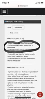

is combo fx correct? thanks a lot!!!!
Posted Tue 19 Oct 21 @ 7:28 am
No, that was not for your issue with Color FX.
However the next update will include a fix for your issue as well.
Fortunately the issue could be fixed without a skin update.
Instead the default mapper has been updated to address that situation.
If you're using the default mapper then all should be fixed automatically for you.
If you use a custom mapper then let me know so that I can point you to make the necessary corrections on your mapper to fix this issue.
