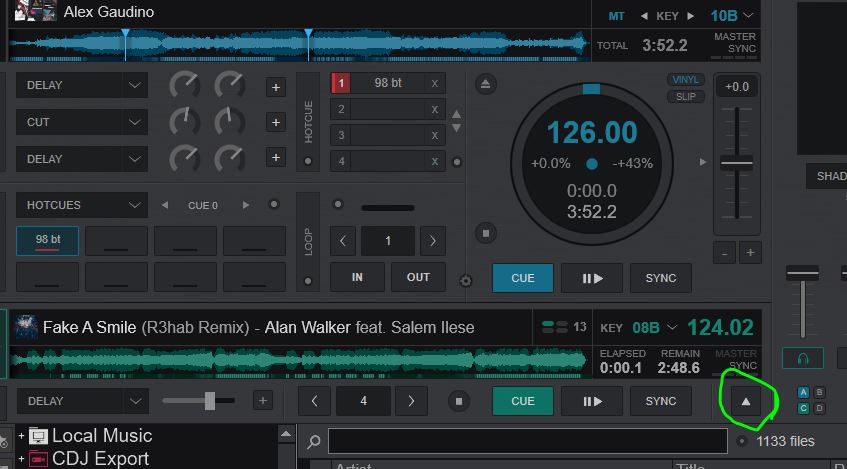

I am using last Pro skin with 4 channels.
Channel C & D are minimized.
I am looking for a way to unload a song from these C & D channels and nothing works. There is no unload button and right clicking 2 seconds on Pause/stop button has no effect. Any idea ? It was working with old VDJ 8 skins. Thanks

Using 4 deck controller? if so just click select deck 3 or 4, and that toggles what decks are shown larger on top (with extended buttons).
Or click the up arrow in the skin, to move the deck "up"

Thanks Rune, this is the workaround i use right now but it seems to me a bit tricky when playing and stressed by other urgent activities during a mix :-). it was so easy to keep the right click on the pause/stop button. I don't understand why it deseapeared ...

Another workaround:
You could create 2 custom buttons:
Left deck:
OR
to unload the minimized deck's track (left side)
Right Deck:
OR
to unload the minimized deck's track on the right side
Or one custom button:
so double click unload deck 3 and single click unloads deck 4
Or modify the controller mapping's DECK_SEL buttons to add something like:
if there are 2 buttons for selecting like on a Denon 7000
if controller has one button to toggle between decks:
(not tested)
so a double click unloads the minimized deck's track.
Left deck:
deck 3 unload
OR
deck 1 leftdeck ? deck 3 unload : deck 1 unload
Right Deck:
deck 4 unload
OR
deck 2 rightdeck ? deck 4 unload : deck 2 unload
doubleclick ? deck 3 unload : deck 4 unload
doubleclick ? deck 3 unload : deck 1 leftdeck
deck 1 leftdeck ? doublclick ? deck 3 unload : deck 3 leftdeck : doubleclick ? deck 1 unload : deck 1 leftdeck
(not tested)
