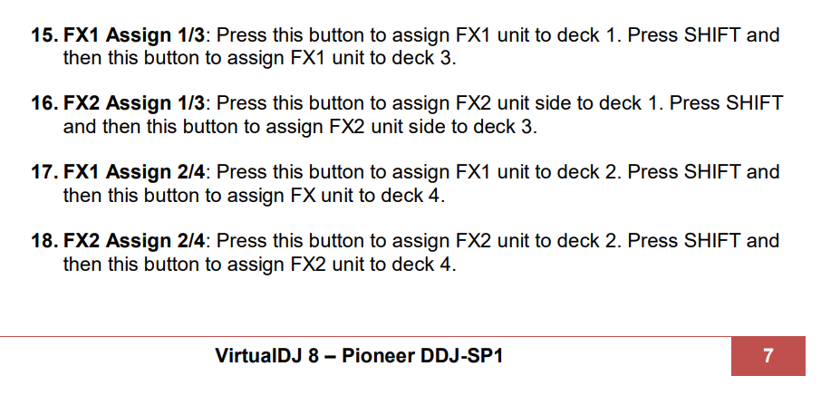

Just as a curiosity, I found the below on pioneer.com. I know it was meant for VDJ 8, but has this (fx assign) ever worked like this in VDJ?
