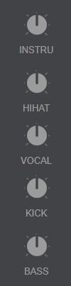

Can some one verify that with VDJ BUILD 6091 and eqMode = Stems
1) software does not display INSTRU for the top knob and BASS for the bottom knob
as shown in video taken with controller NOT connected (drag vid position with mouse to see how each knob appears with each of the EQ Modes each mode is about two sec and can be held in each mode by dragging slider at bottom of video)

Summary: When eqMode is set to either EZRemix or ModernEQ, the software functions as it should, and displays the knobs correctly
AND when eqMode = Stems that software does not display INSTRU for the top knob and BASS for the bottom knob and does NOT always control the Stems correctly (believe upper knob works, and lower does not)

The labels are shown when selecting the EQ mode:
People naturally expect the skin to show the same thing.
As I mentioned in an earlier thread, it's necessary to show the correct labels on the skin because
A) The function has changed and
B) Connected controllers have fixed labels - so the change in function has to be visible somewhere, so the user knows what to expect when using the control.

With VDJ BUILD 6091 and No Controller connect and eqMode = Stems the upper most Knob is labeled GAIN and it controls the Gain... ie NOT INSTRU of Stems mode,
AND the lower Knob which I have configured for LOOP ROLL controls the Loop Roll effect NOT the Stems BASS.
So they do NOT control the Stems as they should for me.

d) turning the INSTRU (or top) knob on the controller https://gyazo.com/0068da71d82286bf6ddbf9e7d754279b nothing
e) turning the BASS (or the bottom) knob on the controller https://gyazo.com/fd8ba315bb2223d471cc213f028a136c again nothing

So that you can still access gain and filter using mouse on screen, since they are no longer available on your controller.

Sorry but that makes even less sense, IMO.
If a user has intentionally switched their system to five band stem EQ mode, they surely expect all the controls to be in five band stem EQ mode - not for the physical knobs to be doing one thing, and the on-screen knobs to be doing another.

Your videos don't have audio, but the knobs should work in controlling instruments and bass, even though this is not shown on screen.

after checking. The controller does change the audio by changing the Stems .. of the playing track.
Its just that the software does not show the movement of the upper most knob in the software, and I imagine that this is as expected, since the upper most knob is not INSTRU , but GAIN on the software and the controllers upper most knob is controlling INSTRU. So all controllers would/should function in this same manner.

It will be updated a little bit in the next update so that the label will change when moving the knob on the controller to better understand what's going on.
In the case of using stems on the outer channels, it will also be possible to actually control stems from there using a 4-deck skin, since in that case these knobs were not in use by a deck anyway.

And its been updated in the early release:
Quote :
BUILD 6100 (2020-09-10)
-gain and filter label temporarily switch to stems when controller stem knob is moved and eqMode set to Stems
