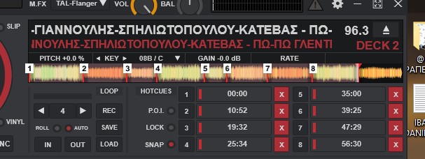

I had a look but couldn't identify what element of that code was represented by the small stripes I'd like to make bigger or change color in order to highlight? Or is that element part of the Sprites within 'img.png' of that skin? (even so, I did not manage to see which one it could be so far; I'll keep searching :-) )

didn't you looked for "scratchwaves" ?
there are some with orientation="vertical" with "<grid " child :
<grid mirrored="yes" pos="-3" color="wavegridcolor" maincolor="wavegridcolor" backgroundcolor="wavegridcolor" background="no" backgroundshaded="no" height="3" size="1" mainsize="2"/>
just modify colors :
and size :
I use to make main the color of the deck i.e.: maincolor="deckselectborder"

not being really familiar with coding I must say I had some difficulties.. A nice WYSIWYG editor would be great ;-)
Anyhow, based on your indication I managed to find few lines of codes inorder to adapt towards what I was looking for ;-)

could we please add 2 things in a future update :
1) a button (shortcut) on the skin for switching to stems and back instead of having to enter the settings.
2) display of hotcues 9-18 on the preview waveform on the deck (with the little number). it only shows up to hotcue 8, after that it only shows a line without a number.

would anybody else know how to add the hotcue numbers from 9-16 to the deck preview waveform in any of the 2020 and after skins ?
where would i have to look in the skin xml ?

I will bring this in a Future Update.

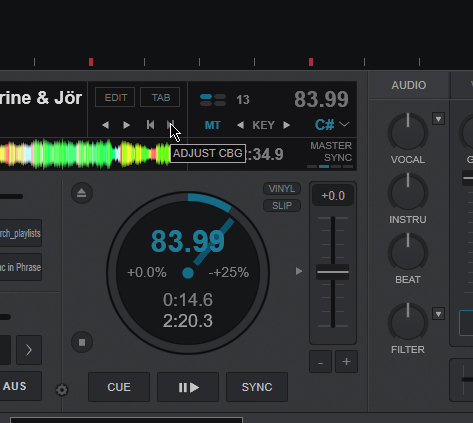

Hi Denny, in the original skin you can click on BPM at the top of the deck information to easily change and adjust the CBG. Is this possible in your skin as well?
