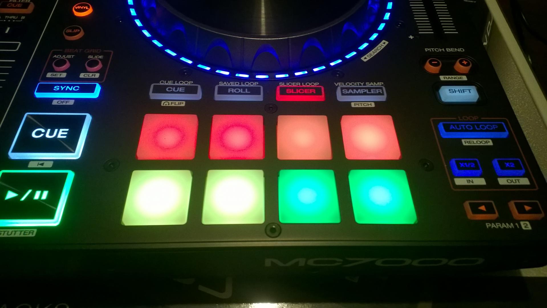

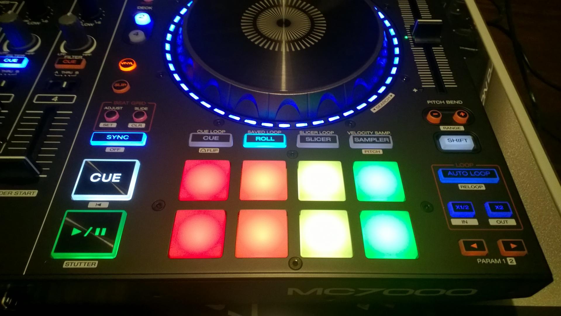

Beat Jump Size
Loop Size
The 2nd page button changed from ROLL to LOOP SIZE. Colours programmed to match the beat jump size colour. Due to how this naturally lays out it's a clear difference. The side by side matching colour is forward back beat jump. Bottom top matching colour, bottom matches the loop size, top is the fractions. Beat jump and being able to instantly trigger different loop sizes are the most important pad features in my opinion. Most of the time it's not simply halfing a loop, we need to jump from and 8 beat loop to a 1/2 beat loop, then back into the 8 beat loop, creating that little stutter effect before the next bar. When you get god at this, you can jump from the 1/2 to 1/4 quickly (or vice versa) all before you return the loop to 8, whilst remaining in sync and phrasing with the mix.
8 Beats Green
4 Beats Yellow
2 Beats Orange
1 Beat Red
I'm going to make another pad page CUE HOLD (Cue that only plays when pressed down, returns to Cue on let go) but i don't know the code for this. The main cue page will still be the normal cue. I'd love to change the colour of the ROLL button too.
Beat Jump Size
Loop Size
8 Beats Green
4 Beats Yellow
2 Beats Orange
1 Beat Red
