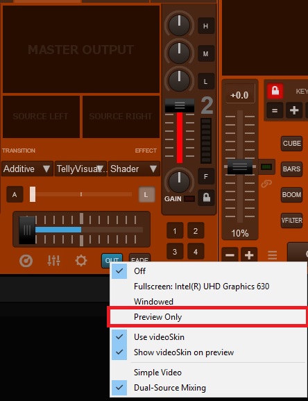

I use VDJ8 with a videoprojector ... i have attached a script to my controller to switch on and off the video-Out and it's work fine via scripting except that when the video out is OFF even on my skin i cannot see the video track... I have seen a "preview only function" is it possible to leave this preview function always on ? i haven't found any help in a way to script this function already.... the best for me would be to have a preview only function always on on my skin and when i am ready my already scropted controler button will make the video_output "on" to the videoprojector .. any idea ?
Thank you for your time ...

It is not currently possible to close the master output keeping the preview
however you can make it windowed small size and not always on top making it invisible for both the output and your working space
instead of closing output you make it windowed and fullscreen instead of turning it on on

NicotuxHome userMember since 2014
No, sorry i was wrong !!
It seems there is a solution
video_output ? video_output off : video on
this cuts the output keeping preview on and restart video with preview
Posted Thu 11 Jul 19 @ 12:13 am
video_output ? video_output off : video_output on
Posted Thu 11 Jul 19 @ 1:02 am
freppaPRO InfinityMember since 2002
This is in Fruits skin
This is also in default skin.... the question was about how to do it by script, without a menu
In fact the answer was really too simple: It is the example in the description of "video_output"
and this description is not affected by display issue. Just not clear to figure out what it really does
